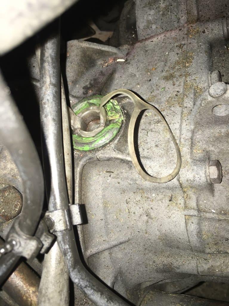

Gear box inspection hole, does anyone know of anything I can buy to remove this???

Put the new one on finger tight.
They are a nightmare to get out sometimes, as already mentioned the white plug pulls out and you will need a large nut or Allen key you remove it if you can't tap it around like your mechanic has tried.
I had trouble removing mine but I was taking the gearbox off so I waited till then and destroyed it while hammering it around with a large screw driver and hammer and collect all the bits from the floor. Once you get so far tapping in around it usually becomes easier you you are able to unscrew it by hand.
It you do try this method keep the white plug in as you don't want bits of green plastic going in the hole.
New one looks like this, lots of places sell them.
http://www.ebay.co.uk/itm/VW-MK1-MK2-Golf-Genuine-Gearbox-Inspection-Plug-Cap-020301129-BRAND-NEW-/271144195259?hash=item3f217414bb:g:~lUAAOxyDEVSdsn~
When I put the new one in I only screwed it in a little so I could still undo it, it's not all the way in like yours but still keeps the dirt out.
I don't take it out very offen as I don't use a timing light as there is very little room to shine one down there and I time my car by ear and driving but you only really need to do it once.

IIRC on my 81 Diesel and 90 cabby, I had to use a Drift on the edges of it to "Loosen it" so I could turn it by hand. I did also carefully soak the thing in wd-40 as it is after all Nylon in a Aluminum body. I didn't smack the large part, I smacked the edge that was ontop of the housing,,,, that little lip.
Not the Nutted sides or Allen insert lip.
You want a small spray of oil that won't seep on to the clutch.
and I think 27 is correct.
MOTY 2013
worst case just fully destroy it, pullout the worst of the chunks from the hole and spin it over quick, the rest will fall to the bottom of the bellhousing and you can get it out there if its later model with the seperate tin metal cover.
