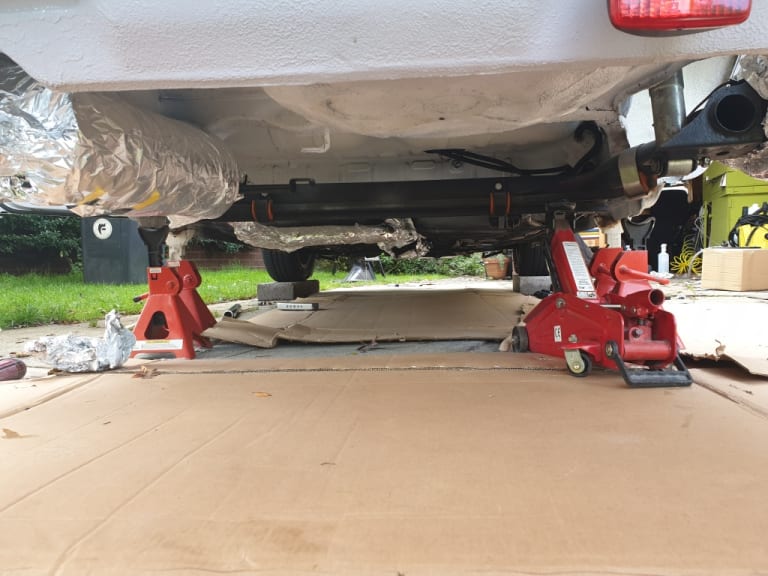

Jack the Car and support it on the Pinch Welds infront of the Tires and Jack it as high as you can get it. Chock the front wheels (tyres).
Take car when lowering the axle about the 5 inches or you will break the rear hoses that connect to the rear hard brake lines, you might want to replace them as they are easier to get to with the axle down prior to going back.
These are about all I can think of. beside Good Luck.
The higher you can jack it up the better!

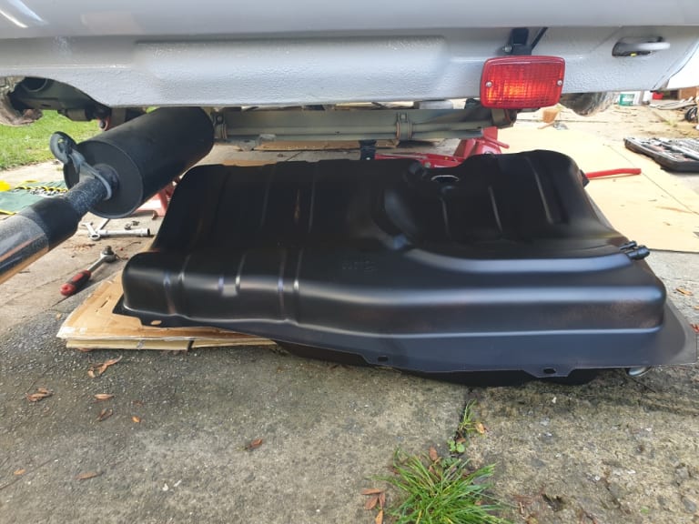

I didn't take the exhaust off, but if I had of it would of made it MUCH easier
Get plenty of fuel line to change them + the breathers at the same time - might as well while you have it out
I didn't take axle off, I managed to drop it quite low - I have just enough play in the brake lines.
I used 4 axel stands and 2 jack's (3 actually at one point!) but you could do it with 2 and a single jack, having the extra ones just help support and hold things as you drop and remove bits and I put it back in on my own so it helped me hold it in place while I did the bolts etc.

yep, i removed the bottom shock bolts.
i did not remove or undo any of the brakes - my hoses had enough play / length to drop it that far although i am not sure if its the same on all models.
