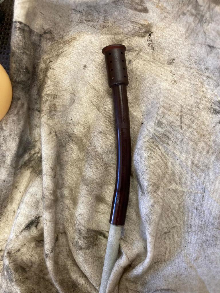

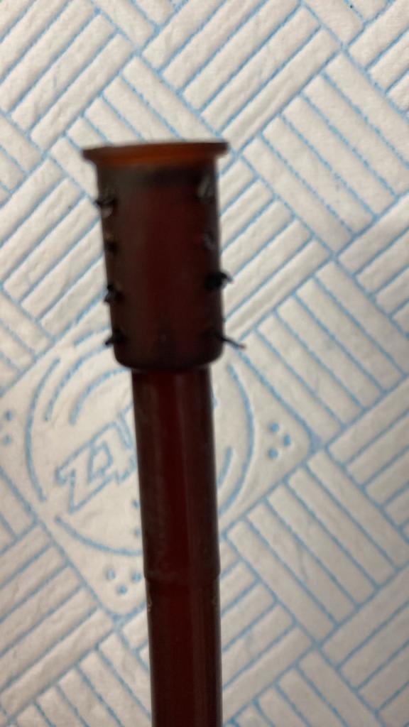

Pics are fuel tank lid invert
Fuel pick up pipe full length (cleaned)
Pick up pipe has now had end cut so it is not capped it's pure Straw pipe like .. see the filaments sticking out pick up..
Dirt flakes
Paint primer flakes
Rust
Possible filler sludge .

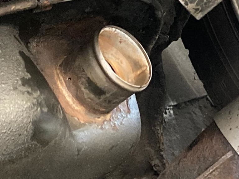

Update it failed small hole at fuel tank neck.
So its new tank
The neck is not held by any more than filler possibly.
I wish I never skipped that bit …if it was pointed out..🤦 Bolts present ..nuts disentergated .
