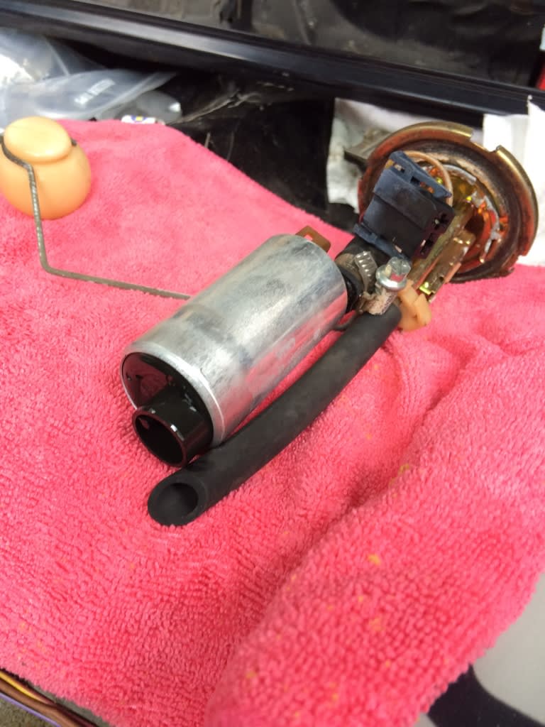

Removed inlet to main pump under the car and no fuel coming out of the tank to the main pump. Done some electrical tests around the lift pump connection and appears no power getting to lifter pump. Anyway, removed the rubber hoses and removed the lifter pump out of the tank completely. then connected the battery directly to the pump connections - looks like the pump was somehow 'stuck' as doing this somehow kicked the lift pump back into life - lift pump now coming on. Put the lift pump back into tank and reconnected all hoses and returned Relays back to where they should be. Car is now starting first time. Which is great.
However, there was fuel pouring out of the fuel lines under the engine. Closer inspection pipes look corroded - so it looks like I need new fuel lines.
Also noticed some rust in the tank - probably coming from the corroded fuel lines maybe? the tank and filler neck were all replaced about 5 years ago and still look clean.

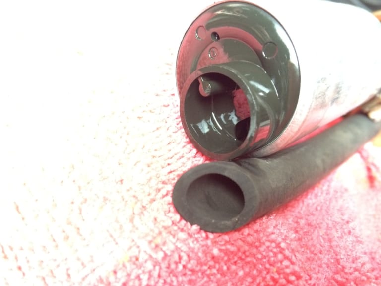

Another thing I noticed is the lifter pump doesn't have any strainer attached to it. and it isn't in the tank - Does that mean its been installed without a strainer attached? do they come without strainers? should I get a new lifter pump too with strainer? See image:
Anything else you think I should be replacing? or cleaning? at this stage before driving again?
thanks again guys.
A trick to keep the filter on the pump as you install it is:
Then before locking it in place, snip one side and pull it off.
Briano1234 said
Great tip!
And managed to find the strainer in the tank - hopefully no lasting damage to lifter pump.
