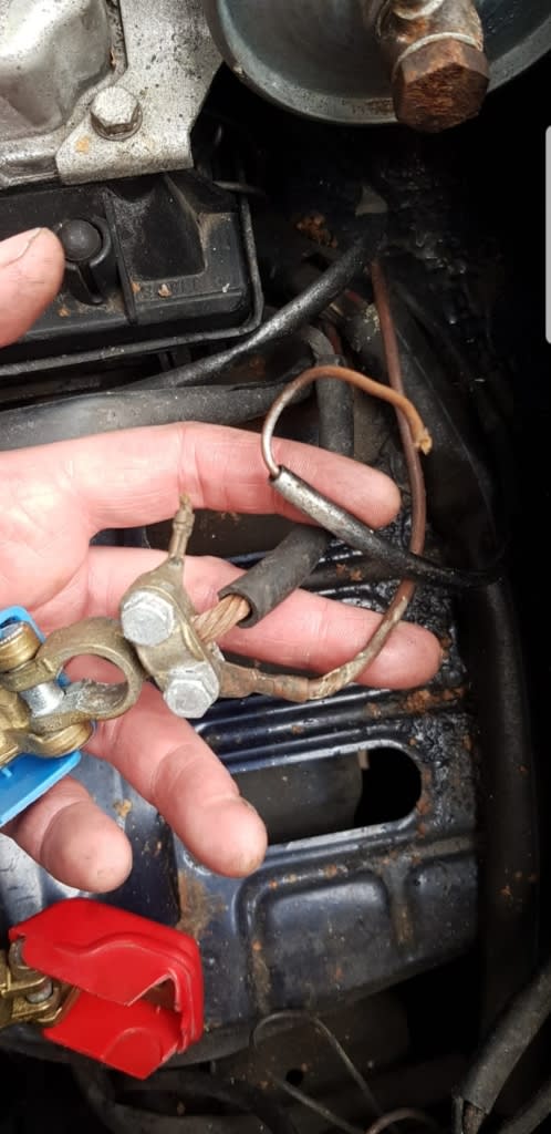

You say bad grounds…afterward I noticed that a small brown wire meant to be going to the negative terminal had snapped. Could this possibly have anything to do with it? I've since fixed the wire but not tried again

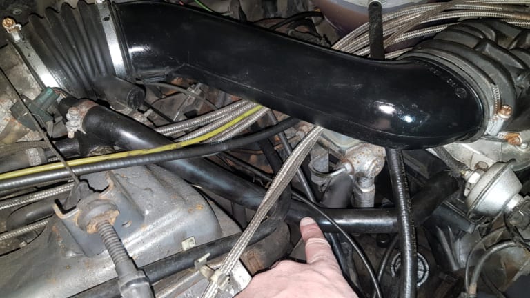

When you say "floods the metering head", where is the petrol appearing? The fuel side and the air side are different, the air is used to control a plunger which regulates the quantity (well, pressure) of fuel which is in turn distributed to the injectors. No fuel should enter the airstream directly within the metering head.
Its quite possible the 5th injector is leaking and/or stuck open and/or running on due to being electrically commanded when it shouldn't; or the main injectors are leaking too. This would be the obvious place for excess fuel to enter. Once in the cylinders it will seep past rings and into the oil/sump.
Regional Host NE
distribution unit into the air filter box or
externally, the sensor plate raised
really is the only way fuel can get
to the injectors
The metering unit floods petrol into the air filter box and it also floods the sump I'm guessing that's through knackered injectors/seals through the cylinders after guidance on here, I will be testing them asap.
Anyone any idea why the petrol would leak into the air box pls
