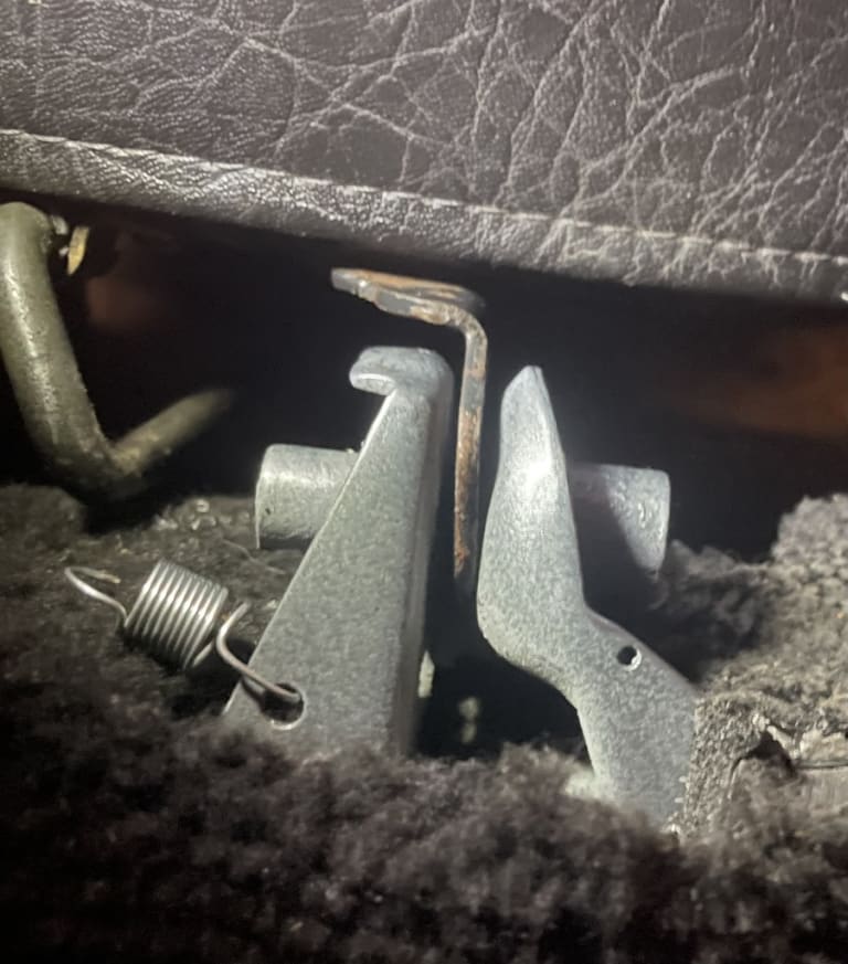

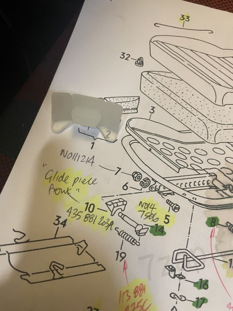

I cant for the life of me work out how the 'front glide piece' is supposed to fit when re-installing front seats. It is item 10 on the attached diagram and you can see the part ive bought from VWH. Ive found a few pictures online and my mate sent me a picture of his (unfortunately hes 400 miles away so cant see it in person) - but im still stuck.
Obviously the middle rail under the seat is supposed to glide along this piece and to avoid metal to metal contact, I just cannot get it to fit in the seat support steel….
Can anyone help?

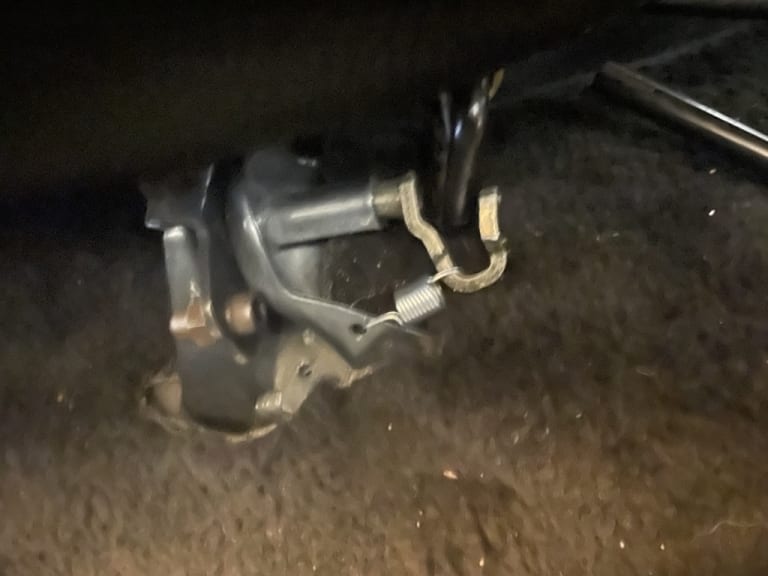

Below photos are my car (grey paint) shown without the pice installed (obviously) and my friends with the pice installed, circled in yellow.
Also, Etka diagram and the part I've bought: p/n 435 881 203 A
I *think* it just slots in between the sliding rail of the seat and the opposite side to the sprung retractable locating pin. Which way up, or whether the fins are up or down I can't remember but I'll have a look when I get back home.
His is showing that the glide piece is sitting on top of the vertical to the right of your middle pic (on the side the retractable spring locating pin is).
His looks distinctly wider than yours, and looking at the glide piece picture you show there is a locating lug too.
My best guess is that the new part you have is designed to sit on top of the side of the channel and that maybe in the wider locating channel of your mates golf there is a recess for the lug to sit into so that it doesn't move with the seat. Like your friends setup.
But mine isn't like his. Mine is an '82 and has really skinny verticals here and the glide piece just sat to one side.

There is a lug on the new piece but neither side of the support structure has a hole that it would go through, so im wondering if its not compatible.

It does in fact - on mine - sit on the top too, and on the side of the retracting locator pin.
I can't recall if there was a lug hole in the top so I'm afraid I'm not much help.
This picture was taken from the front if that is of any use. Slightly further away.

Actually I was almost totally wrong. Sorry about that. I did have a picture after all - just found it.
Great picture thanks ill try and put mine in the same position - I just dont see how it will stay in place….

You can see metal tab (yellow arrow) prevents the glide piece slotting into position, as the plastic tab on the glide (purple arrow) clashes with it…

Thanks, I did see that other style, but from the VW Heritage site it appears to be for cars up to 1980 only.
Mine is an '82 GTi the same year as Argomans so can only assume i have the right part, it is shown as being suitable up to '83.
The rails are all good, the car has had a full strip down and respray I just need the front glide piece installed so that its not metal upon metal when it glides

Your 83 doesnt appear to have the metal tab I've arrowed in my above picture, strange given mine is an 82.

It looks like you have the metal tab on the support, like the one I identified with a yellow arrow above? In which case, there must be a hole in the top of the metal guide for the plastic tab to sit in?
