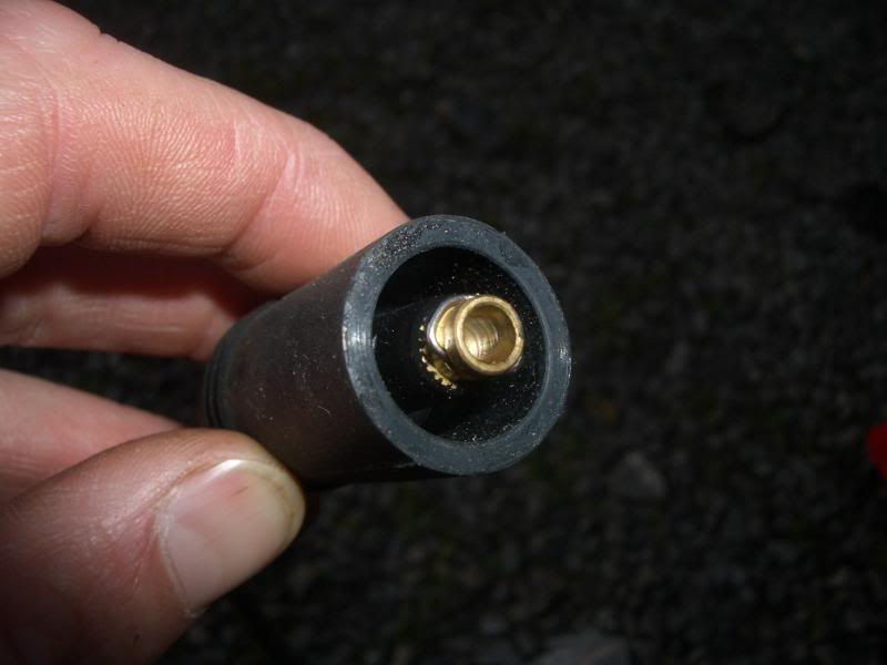

I recon you have the pin type cap (also know as sawn tooth) pull a hit lead off the cap and see what there.
I'll try and find a picture and post it up later tonight.
Ne Plugs come with the Tip on, they will not allow the High tension lead to engage.
You have to hold them with a plier and unscrew the tip.
Later type with sworn tooth/pin ht leads.
HT lead ends are like this for later type.
