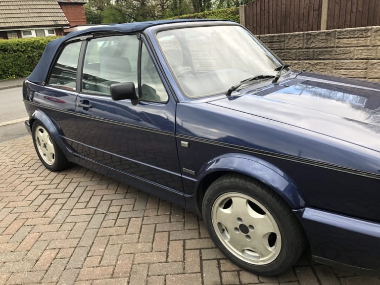

Rubbing rear arches
P.S you need your roof sorting out (side tension cables) or a new roof as it should not look like that….
Still shouldn't rub though as the offset and width aren't much different to the standard wheels
The metal arches don't have a lip at the top on the cabbies so if you just want to stop it rubbing (and do it ghetto style) take a good solid sharp knife and gently cut away at the inside edge of the plastic arch. Do it gently by shaving it and try the car again. Rinse and repeat until no rubbing occurs.
But obviously new springs and shocks would be a better fix
Ian
You should also see some marks on either the tyre of the car somewhere to indicate what's catching
