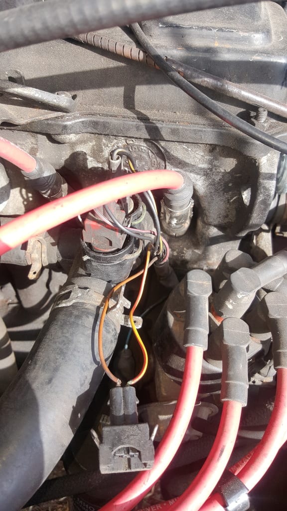

The Engine temp on the instrument cluster no longer moves, although when i start the car the light comes on flashing for few seconds.
I have gone previous threads, and i understand that it could be the panel behind the cluster that needs a good cleaning, and i have seen Brians post about repairing the actual guage. However, i feel it is the sensor in the engine. Before i conclude this i understand i can earth the plug and start the gauge to see if it goes to full…..this is a basic question but how do i earth it? Connect a wire to the earth and put it to the body of the car?
Secondly, does anyone know what the part number is for thr sender? Its a two pin (ive attached a picture) 20180731_093724.jpg
If it is the sender how do i replace? Wasnt too sure via the threads- does it just screw off? Thanks

Twisting the sender isn't really doing anything, but twisting the wires on the sender to "clean" them.  From your picture they look soldered.

I can see now why you are passionate about soldiering as the two wires clinging on to its dear life has come off the plug :( ……now can i reuse the same plug or do i need to buy another one?
Mines defo a two pin black sender…
Damn it
Last edit: by optimusdub
With the correct pin remover you can re-solder the wires.
But I do think that the connector is avail at VWheritage or any generic local Breakers, it is a common connector.
Just cut the new wires off the loom with room to solder.
https://www.vwheritage.com/251919501d-coolant-temperature-sensor-blackgreen-2-pin-20mm-vw-spare
So this is the sender i require.
Unfortunately the 2 pin connector, the wires snapped inside it…..
What specific tool would i need to pull the two pins out of the connector as id like to soldier the wire to these so it remains strong to the cause….something like this for eg https://www.amazon.co.uk/dp/B07D3RCVRW/ref=asc_df_B07D3RCVRW54418832/?tag=googshopuk-21&creative=22146&creativeASIN=B07D3RCVRW&linkCode=df0&hvadid=258366679845&hvpos=1o2&hvnetw=g&hvrand=1239010420331940360&hvpone=&hvptwo=&hvqmt=&hvdev=m&hvdvcmdl=&hvlocint=&hvlocphy=9045937&hvtargid=pla-453195685896
Thanks for the link Briano1234 …..i managed to repair the two pin clip albiet some cowboy soldiering 🙈🙈🙈
The Temp Gauge seems to be moving again slightly.
