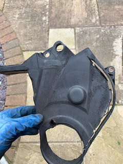

Basically the Intermediate pulley had come loose and the timing belt was rubbing hard against the water pump pulley, this saved it coming off totally!
after being towed home, I pulled the car apart and the timing belt had rubbed through all the belt cover.
Cleaned up the area, ordered new timing belt and tensioner, and a new set of belt covers.

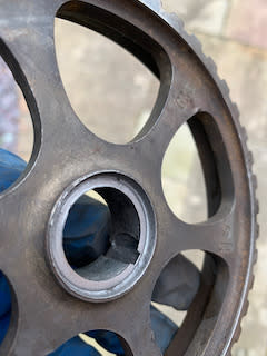

I took the intermediate pulley off to find this
so basically it seems the pulley must have come loose at some point and the woodruff key damaged the shaft and the pulley.
I ordered a replacement pulley, welded the gap and put in a fresh woodruff key. put all the timing back and its all up and running.
Its running as it should and I think all the issues I had in this thread were due to the pulley being damaged and messing the timing up, over time getting worse!
