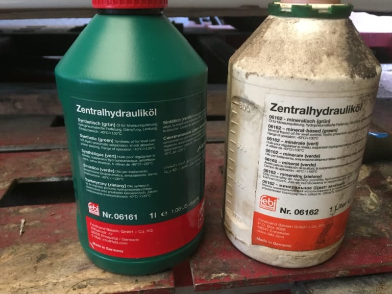

First of all check the level with the hood down.
Check for leaks from the where the hoses go onto the unions and where the ram comes out of the top of the cylinder.
Then top up with this.
I used the equivalent …. This
