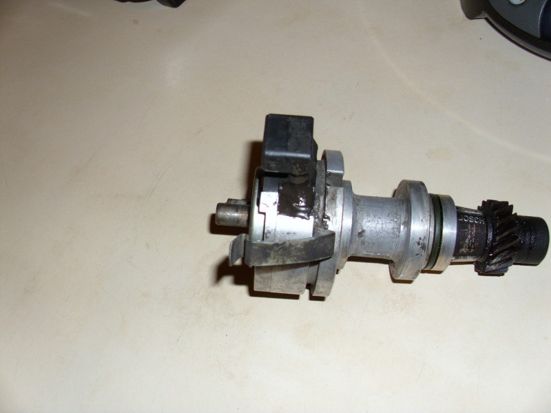

Let it Penetrate the Base and into the block. LET it WORK for about an hour. Spray it again and wait about an hour, spray it again… Then
Remove the Clamping wedge and bolt…
Using a pair of channel-locks or Gasoline pliers grab low on the stem of the dizzy and Gently start a rotating back and forth GENTLY….
It will start to move eventually I have had to work at it for 30 minutes….GEntle…. is key.
I have also used a small Punch and a 4-oz Ball peen hammer to tap side ways to the base that (yes it is tight in there but you have to Punch the base of the dizzy flat where it meets the block. There is a O-RING that welds it self or decomposes to a sticky goo, that glues the dizzy to the Block. You are trying to break this goo glue.
Smack the base….only the Base.
