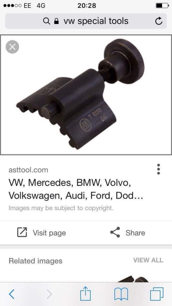

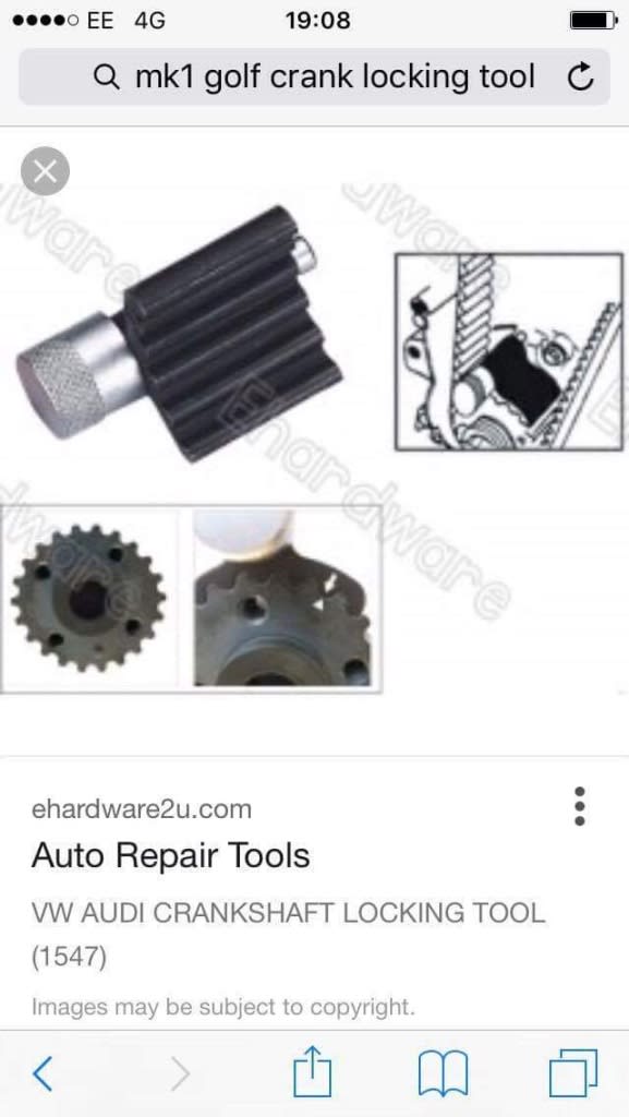

Possible tool found
When you are setting the timing, you get the crank and the cam in time, then you can spin the intermediate shaft it align the Dizzy.

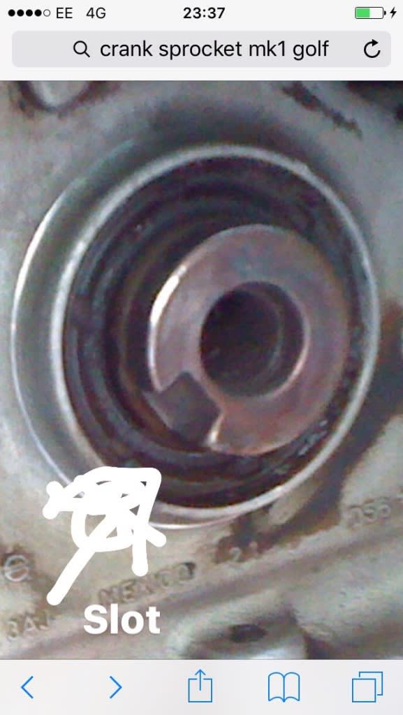

The pn for the correct woodruff key is N0127082 should be 4X5 according to the etka.
I wonder if it could just be the way I'm tensioning the belt maybe as aforementioned?
I see no Scaring to indicate rub wear.
