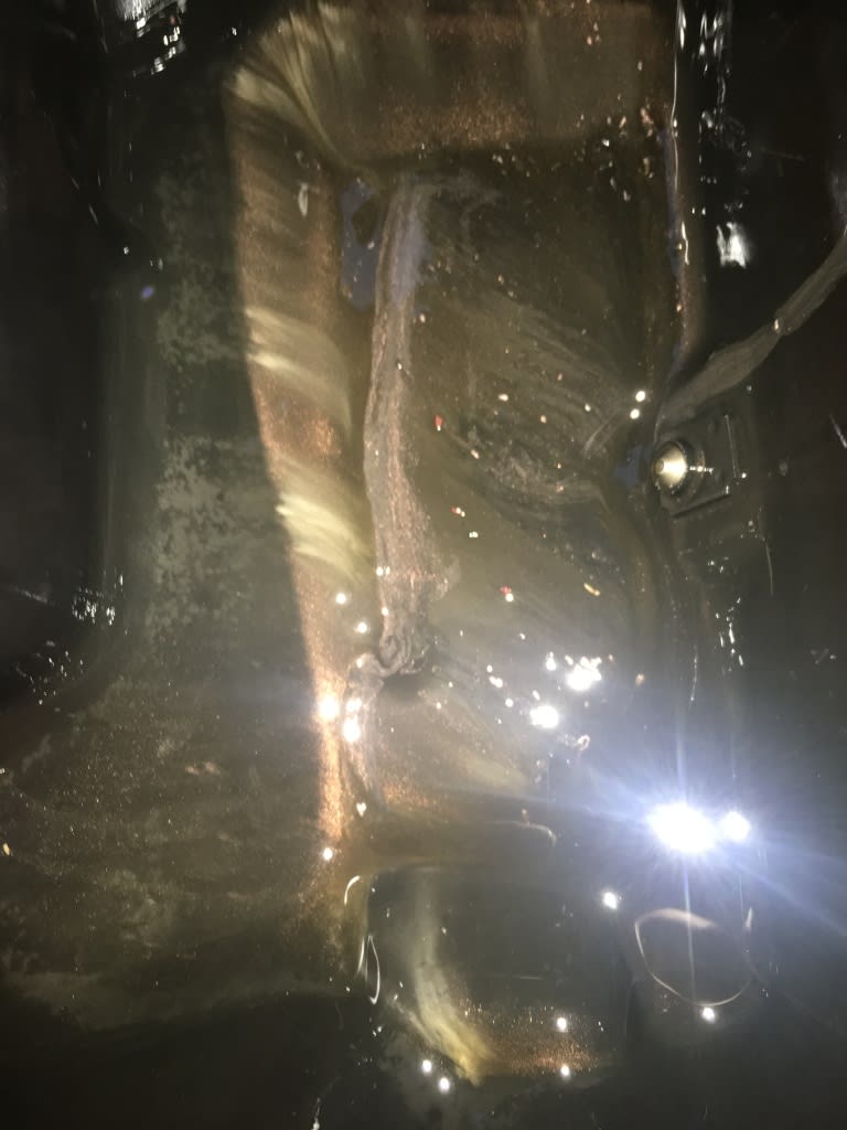

I've taken the sump off and drained my oil and found copper grease left in the oil sump. Why would there be copper grease in my oil. The only place ive used copper grease is on the head bolts?
Do it once and do it right! ok, we've identified the problem, lets not make it worse by guessing……… Identifying the sympton is not the same as understanding the cause
I recently did a head gasket change and put copper grease but quite a bit of it on the head bolts. How could it have gotten into my oil?
Ok, we have two threads here which look like they may be connected.
Are you saying you only put copper grease on the threads of the bolts?
Threads and the washers?
Head bolts should be lightly lubricated with engine oil, to stop this sort of cross contamination but to late for that now obviously.
If you greased the heads of the bolts then the engine oil would quickly wash this copper into the sump, through the pump and most likely damage the bearings.
Looking at the picture of the sump I would suggest (with evidence of big end cap removal difficulty) that at least one of your big end bearings has failed.
The bearings themselves are made up of a copper back, overlaid with a soft white metal which is easily worn / damaged.

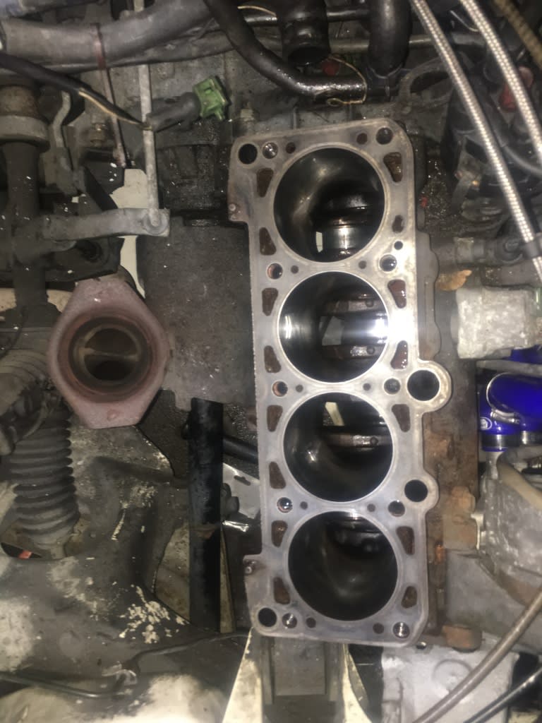

I haven't run it long at all. I merely had it on long enough to bleed the radiator, noticed smoke and stripped it again.
Ok, bad news first, it takes moments for an engine to fail if something is not right. That crank is spinning incredibly fast at idle and is under enormous pressure.

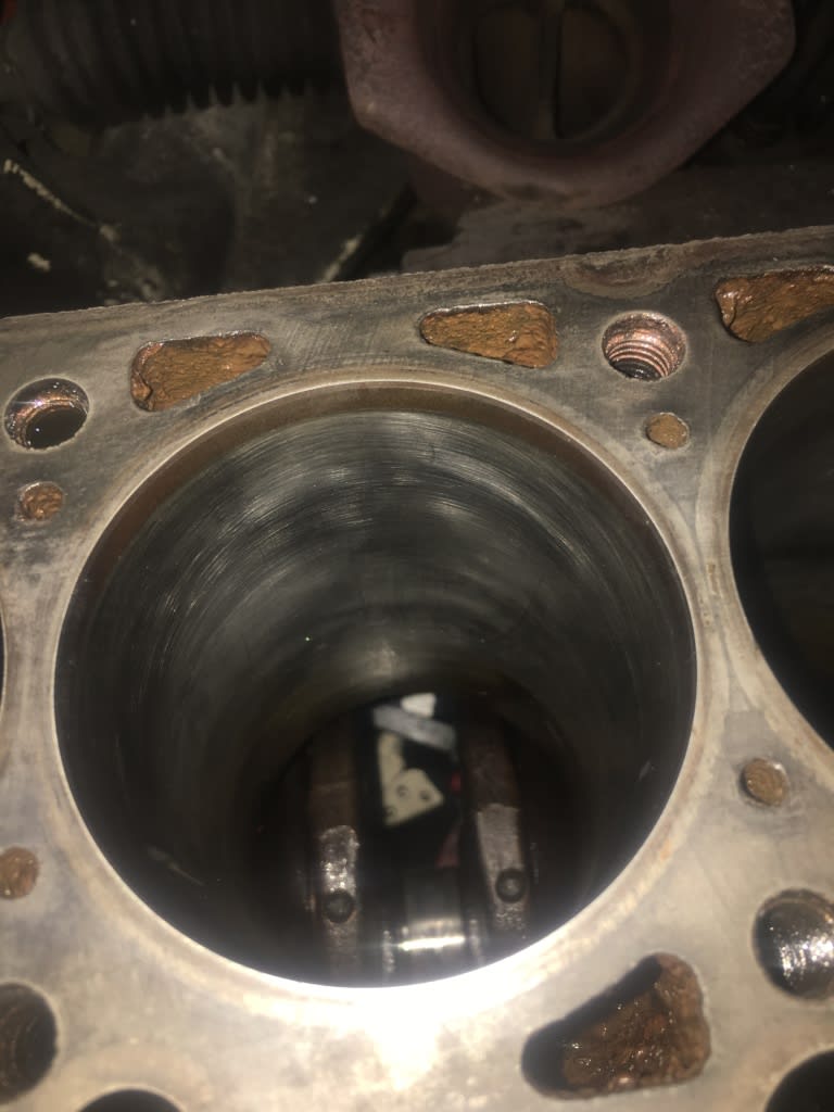

Let me try and make sense of whereabouts you are at the moment.
Head is off? y/n
Piston #4 is out?
Piston #1 has big end cap removal problems?
Piston #2?
Piston #3?
Where all the pistons removed when you had the head off?
Is this the first time you have dropped the sump? And removed / replaced big end bearings?
Head is off? y/n
Piston #4 is out?
Piston #2?
Piston #3?

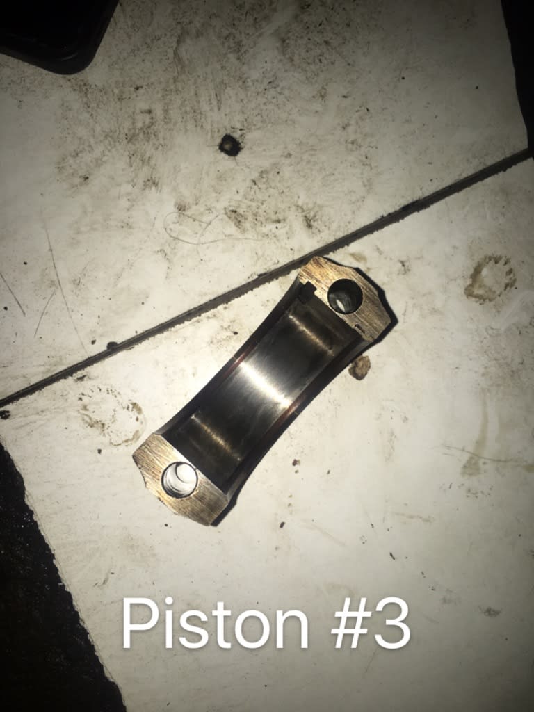

I've had the head off once before and I changed the head gasket and rocker cover gasket. I followed a guide on YouTube called Barry Mcgawen, Scottish and lives in Spain. Put the head back on realised it was smoking so decided this time to take it all off again and change the piston rings and valve stem seals. Piston 1 is out now. Just got #2 & 3 left to get out. Head is off.

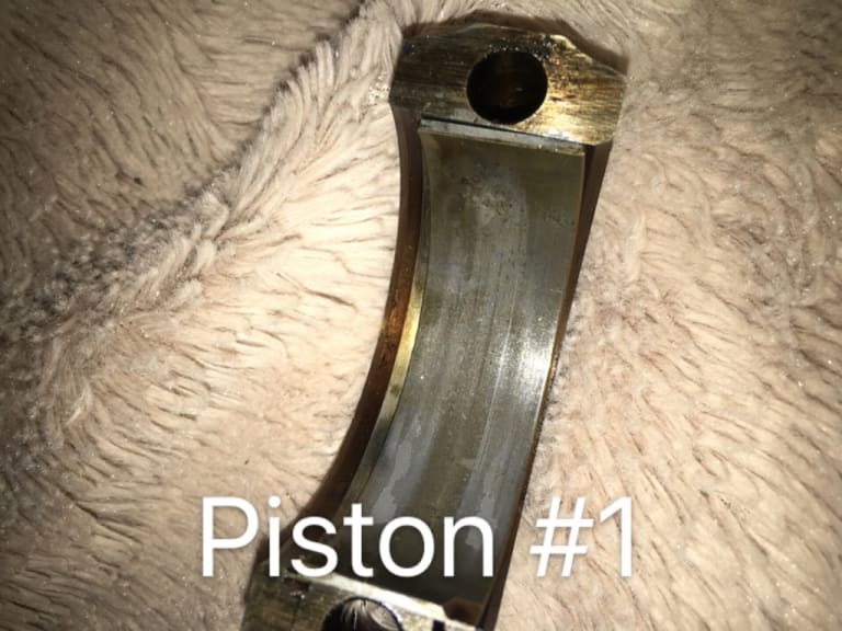

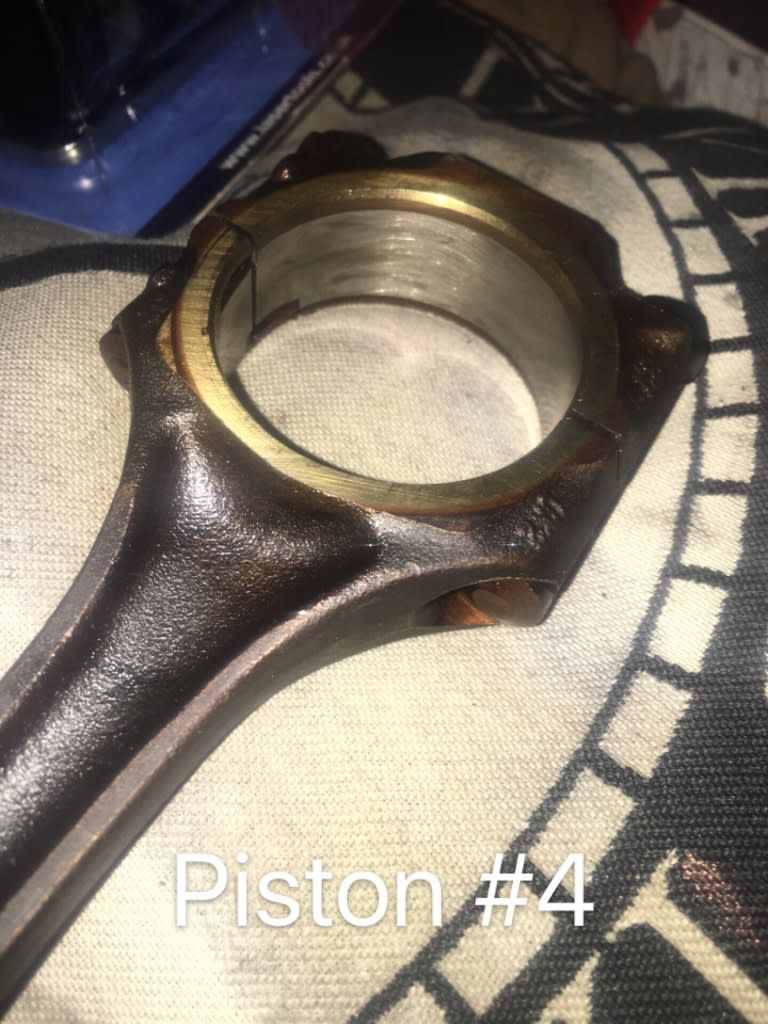

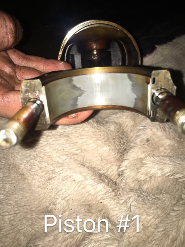

Here are the pictures of the bearings on piston 1.
This is the first time the pistons have been out in the cars lifetime
Ok, is this piston 1, is the cap off?
Good news looking at is that although these bearings are completely worn out they shouldn't have done any damage to the crank
Looking at the picture of the bearing in the big end cap it's kinked over this has to be a result of removing it, but notice how the overlay is breaking away and clear evidence of dirt spiralling into it, hopefully you are just in time.
Looking at the pics of the sump you will need to remove and flush the oil filter housing, the cooler, the pump, the head and the block. Use compressed air to blow out the oil ways in the crank etc etc.
I would suggest that the main bearings will also require attention, check the middle one, it will give a good indication of the rest because this section suffers the most from deflection wear. They must all be changed in a set.

When you get piston 3 out, line them all up and let's have a look at the bearings, don't forget all these pieces only go back one way and are matched to each other, they are not interchangeable!
