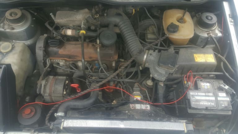

I have just been out in the car, started ok but bit rough then settled down to normal tickover, left it for a while so decided to give it a short run along some quiet roads. Drove fine for a couple of mins then started reving and dying, reving and dying (dropping back to tickover) so drove it back home ok but not running normally ie the tickover is up and down, got back to the house and it sat for a couple of minutes with tickover normal then up to 2500/3000 rpm (by itself, not me doing it) slowly dropping in revs until eventually it settled back to normal tickover.
Anyone ever experienced anything similar or got ideas what the probs might be, I would love to hear them. It's a 1.8i and here is a photo of the engine. BTW while driving it, when the tickover went high I would blip the throttle to try to clear it but it doesn't the revs just go higher?!

Well the 1.8 digifant, Hates Vacuum leaks
There is also the issue that the blue CTS sensor can cause lumpy reading and as it is only @ 9 bucks usd replace it and the o-ring. On the back side of the throttle body is the idle bypass screw 7mm and brass if you can turn it with your fingers then the o-ring is shot and it is leaking air. Count the turns to remove it, then write that number down, replace the o-ring with one from your favorite hardware store and return to the count that you wrote down. Cover the threads and the threads of the screw only with Teflon tape.
Check the static timing of the engine easy to do with a DVOM. No timing light needed.
Static Ignition Timing on VW A1 and A2 DigiFant Engines.
Vacuum leaks and the CTS sensor go a long way, but the last best piece of advice I have it to replace your battery to frame and frame to engine grounds…. The Digi hates bad grounds… You can use two off the shelf cables to replace the single. and at the frame connection under the AIR BOX. clean it with a wire brush, and after attaching the 2 cables spray it with battery corrosion preventative spray paint.
