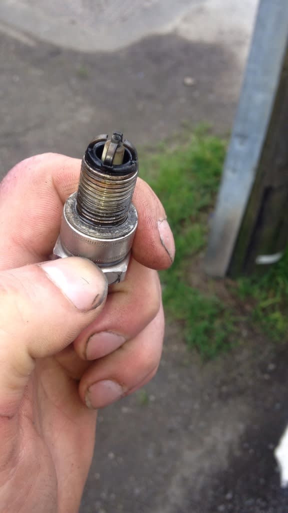

Remember I said I changed me piston rings about two months ago? Well my plugs look like this now
I'm hoping that it's not a big deal? I read in the Haynes at the back it can happen (temporarily during running in?
My co is also lean so they could be overheating? 0.20%

Pop the spark plugs back in as now you have increased the mixture and got the timing set it should help, I would change them for new in 10,000 miles.
I'm praying that my timing is right ! Here are some pics below I took today..
This plug looks oily to me?
Does it to you? Am I paranoid lol

Oily deposits on spark plugs look fine to me, short journeys, not getting the car hot enough can affect what the plugs look like.
