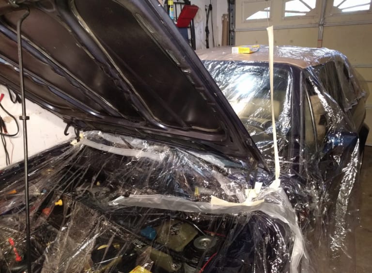

Mask it well as you want to have about 2 feet of paper on each side to make sure there isn't any over spray.
The good blue masking tape and a Exacto knife is going to be your friend.
When I wanted to repaint and clear the under side of my hood. I used cheap Dollar store plastic tarps. and I didn't want any over spray.
I have even used old Christmas Wrapping paper to mask.
