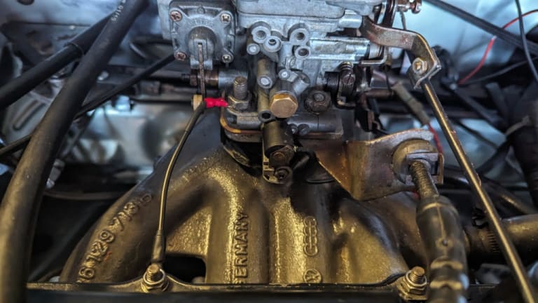

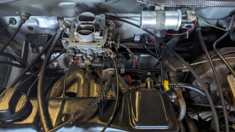

Trying to get my carb Heater working on my 1.8 cabby. It's a Webber carb that never had one fitted when it was swapped but I found an old heater and tried to attach it.
I had to solder a new wire onto it but then I connected it to a spare ignition 12v in the engine bay. When I turned on the ignition it blew the fuse and didn't work.
I recently added the earth wires from the carb to the valve cover, and from the valve cover to the distributor bracket and replaced the fuse, but the same thing happened.
Is it my wiring or could the heater be dead?

barneylarry41 said
Well, I'm sure the heater is dead I had same issues last year September also. I had to replacement it including the wiring.

Thanks. Ended up buying a pierburg 2e that had it on. Swapped it over, replaced the fuse and all is working now
