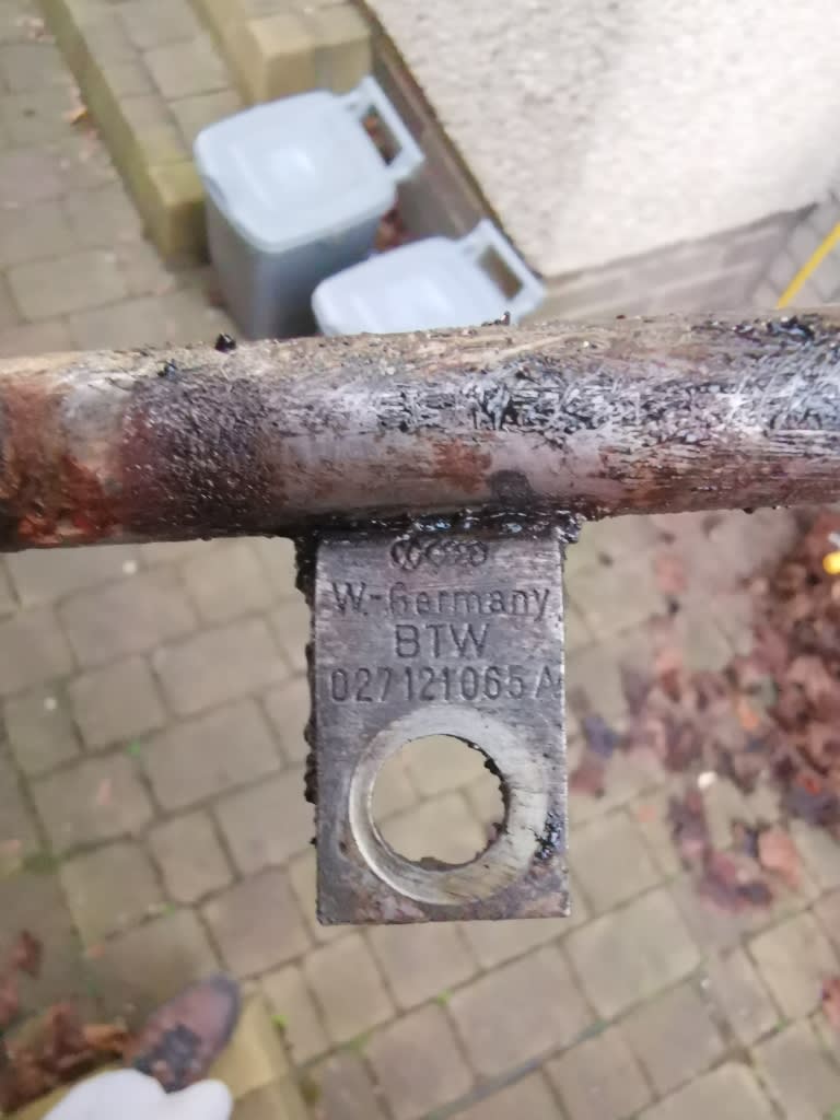

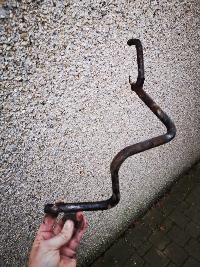

I'm looking for a water pipe for my 85 mk1 gti cabby and can't seem to find it.
Part number is 027121065A
I can find 027121065D VW heritage but thats for a mk2
Thanks in advance

Yes I'm sure it is, the valve site in the middle of 2 rubber hoses before it goes through the bulkhead?

https://www.classic-vw.co.uk/mk1-golf-metal-coolant-pipe-15-16-18-including-diesel-027151065-5004-p.asp
RichardHall said
This is the one I got for my 83 GTI, doesn't have an A at the end of part number but says fits the 1.8 , was perfect in mine.
Thanks mate, looking at it there seems to be 3 ends the one I removed only had 2
Remake a new out of thick wall copper pipe, and solder the connections that you require, you can flare the ends so that they take the hoses or solder on barbed fittings to hold the hoses as well. Where the pipe attached to the flanges you can use Steel, and have it silver soldered to the pipe…
