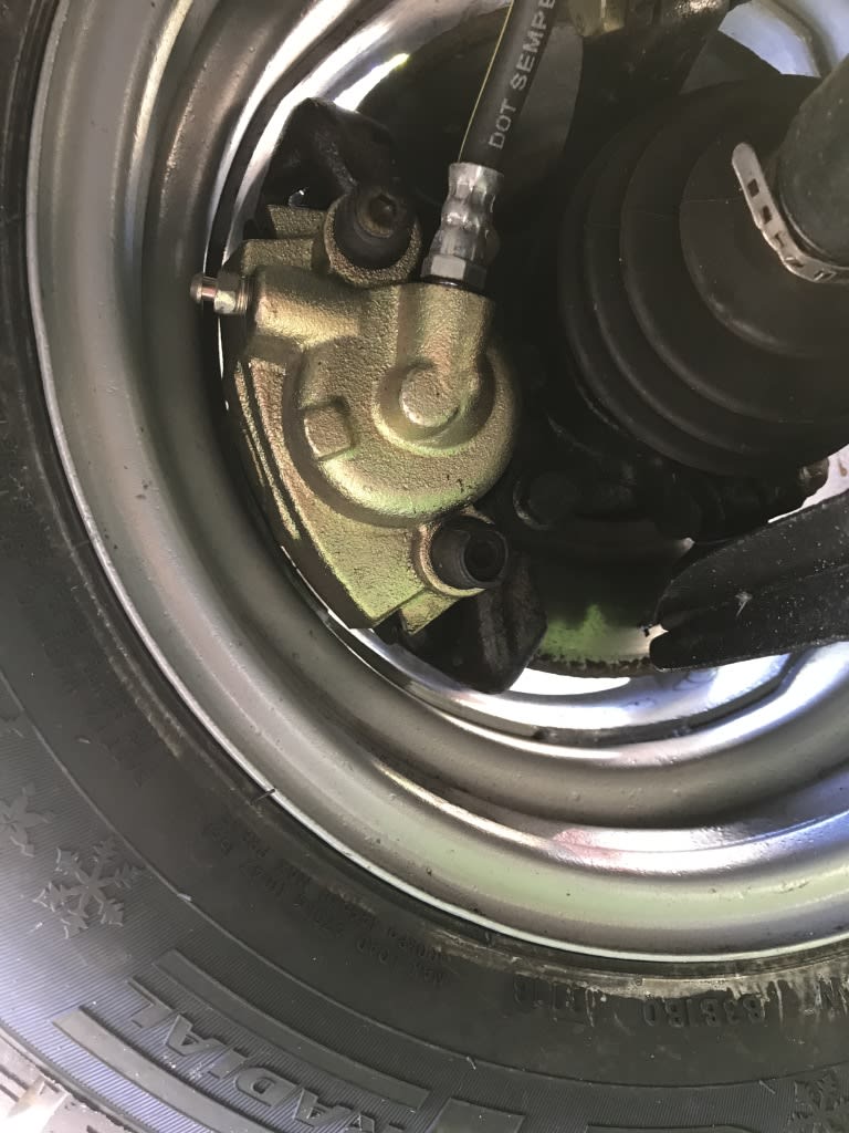

I would love some advise rebuilding the front suspension of 1989 Caddy with many new parts as pistons etc were seized. Ive ended up with the calipers hitting the rims, when the brakes are applied.

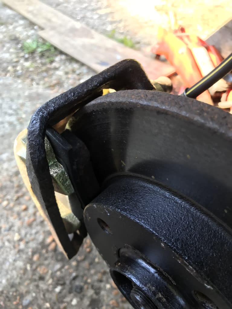

Is it the caliper or the bit the brake pads hang on?
I can see a grinding line on the caliper. Is that you doing a bit of clearancing? Is it only when the brakes are applied?
Seems odd. I'd expect them to grind all the time.
I've had to run some 2mm spacers on the front when running 13" wheels on my Derby but the brakes caught all the time and then it was the hanger not the caliper.

Yes I did a little grinding to see if it was just a casting irregularity!!
Very much when brakes are applied only I thought the caliper moves slightly on the slider bolts and then catches rims.

The appear too thick at the upper attachment…Pbucket is being the posterior the closest I can get is a backup.

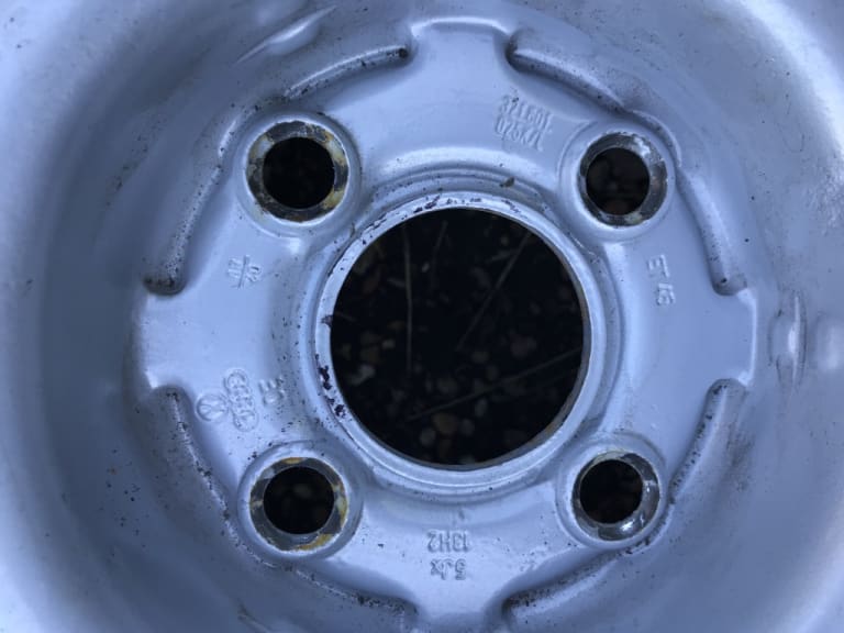

Wheel offset as mentioned above probably needs confirming. According to this, the wheels should have an ET 38 offset.
PCD Volkswagen Golf 1 (1974 - 1983 wheels | PCD, Offset, Center Bore, mounting and tire size data).html
A 45 offset as you have on those wheels will bring the wheel closer in by 7mm. I suspect that is the issue.

As far as I'm aware all mk1 polos came with ET45 wheels.
From the stock of steel wheels outside in the garden I've found all sort of sizes, widths and offsets. But nothing with that part number. Golf ones seems to have raised areas in the centre stamping for the chrome hub caps that were held on with clips. The polo ones don't have a raised area as the chrome hub caps twisted on and were held in place by the plastic bolt head covers, a seal and a bit of luck

borednow said
My 1980 Derby came with steel wheels 13 inch and with an ET of 45.
From the stock of steel wheels outside in the garden I've found all sort of sizes, widths and offsets. But nothing with that part number. Golf ones seems to have raised areas in the centre stamping for the chrome hub caps that were held on with clips. The polo ones don't have a raised area as the chrome hub caps twisted on and were held in place by the plastic bolt head covers, a seal and a bit of luckA lot of googling later: https://www.stevensvwspares.com/vw-scirocco+storm-steel-wheels/steel-wheel62
So maybe a set of Passat wheels?
Ian
