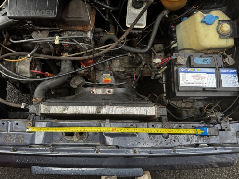

Do i have a 1.6 rad in my 1.8 ?
I need to replace my radiator folks but all sales sources i am looking at suggest a larger rad than i have today ..
The common suggestion is for my car (a H Reg 1.8 Cabrio, carb, non AC) from VW Heritage is 321-121-253/AL which has a 525mm x 322mm core.
From GSF its AVAVNA 2045 which is again same core as the VW Heritage one.. So both sources suggest I should have a larger core ?
My core however is 430mm x 325mm which when i search it on GSF, comes back as AVANVA2024 and this is listed as the rad for the 1.6 cabby.
Soooo - do i :
- But the 1.6 Rad and accept its a direct swap
Or
- Buy the larger rad (which i assume should fit albeit will be closer to the battery box, assuming i keep hose end mounted in same position it'll push extra length to battery box direction).. but then i'll also need a new fan cowl and my current one obviously will be too small to mount up.
Random related question - how do i actually confirm i have the 1.8 rather than the 1.6 ?
Its registered as a 1.8, but doesnt mean it hasnt been changed i guess.
Any help appreciated..

Ok quick update .. I have an EX engine so 1.8 …
So has anyone else seen this smaller rad from a 1.6 fitted to a 1.8 before .?
I guess my primary question above remains - swap like for like or fit the larger 1.8 rad ? (Plus new fan cowl etc)

My 1987 1.8 EX is the shorter 430. Note when I was looking some rads have a 20mm(?) depth (when looking from above) but yours looks the more standard 34mm.
Think the confusion is the MK2 hatch/later Mk1 Cabrio one where ther are the same year Golf but different vehicles?

Brilliant thanks for confirming …
I've just ordered the 430mm core rad from classicvw- very reasonable price too !!!
