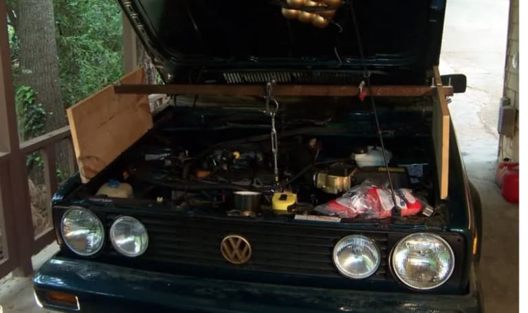

I have used a engine support for years and never had issues with removing any of the mounts as the engine is supported from the top, and moved to the proper position.
This is a version of it as I needed it a tad taller to get leverage.  I normally used 2X10's on the fender rails.
I have used this for major Engine work for years as in dropping a crank, removing heads, and replacing deceased motor mounts.
Using ratcheting straps also work when I have to totally drop a tranny, but Turn Buckles are the bomb and allow for fine adjustments in height. when replacing mounts or removing them.
