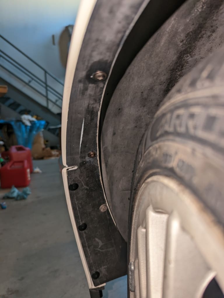

finally got the Rivage back from the disaster of a 'specialist' repair shop after two years and one day. Just gave up and cut my losses.
Slowly working my way through all of the faults with it and replacing all the parts he broke/lost etc.
One thing that is killing me - there is a triangular fillet piece that sits in the front of the front wheel arches and links the rear of the front bumper to the outer edge of the arch / the wheel arch liner. Can't find it on ETKA or online with descriptive searches.
Any part numbers / spare / templates etc or am I making some?
Thanks, Chris.

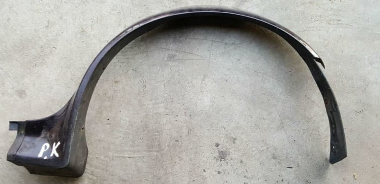

Either the fillet piece or a complete inner arch which extends out of the metal wing arch and fixes to the back edge of the bumper.
I don't understand why ETKA doesn't show it..
Thanks, Chris.
Regional Host NE
It's not arch liner is actually the clipper body kit arch.
The forward piece on my arches must have been cut off both sides. Or the guy repairing it lost the arches like he lost a load of other parts and replaced them with some damaged / cut ones. FFS. Something else to sort but that's going to need paint and, and, and… Jesus Christ I'm £5.5k and 2 years into welding and paint and I'm still finding stuff like this. So incredibly annoyed. Thanks for your help explaining. The pic I posted of the white car is one I saw last night; that had individual pieces there, I'm going to pick up a pair of s/h arches with the joining pieces and cut them off and use them like that for now. At least the bumper won't be loose at the rear.
Also in reality I think it's just a piece of abs plastic maybe could prob nip down your diy store and get some flex plastic and cut it to suit. Or a scrappys and just get some bumper or skirt plastic off anything really as long as you can cut and shape to what you need.
155 853 718
155 853 717
Very annoying that someone has cut that part of the wheel arch off, I guess instead of wrestling with rusty bolts (the heads round off easily as exposed) they took the easy option…
