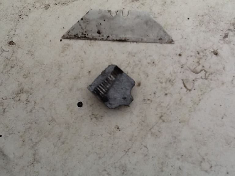

Broken bit of casting on cylinder head :(.

Head casting broken off
Will a good dose of Aruldite do the job or does it need specialist welding ?

i know know you can get weld weld glue -

I recon you may have problems glueing it back on with JB weld and bolting on the alternator bracket with the original bolt, I could be wrong as I've not used JB weld before…
If you are going to use JB it needs to set about 24-48 hours depends on temp. You will need to clead the surfaces with a Stainless Steel Brush and Alcohol.
Do not trust your eye on the mixture, it is 50-50 to get the best strength, and if you have a heated space do it inside.
If you are going ti use a smaller bolt or even the correct one, I would WRAP the bolt in 2 layers of Teflon Tape.
I would use a Washer on both sides of the break so that you have additional strength..
The only issue that I see is that this particular area is prone to axial vibration. As the motor rocks and the top bracket does wiggle, you can feel it.
You might try a welding shop to see if they could weld it in place.
They also make a product called Dura-alloy, or Duraluminum that allows you to use a propane torch to weld the pars together.
You will also need to rig up a brace so that the parts are kept together as the glue sets.
