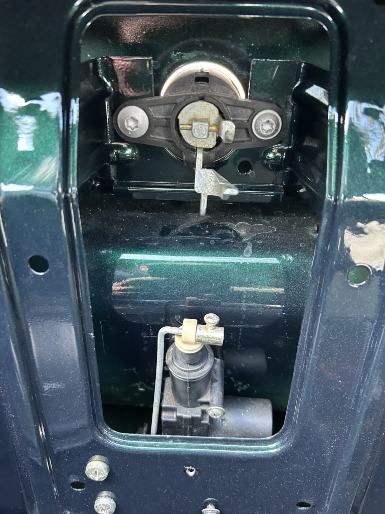

Thank you for the prompt responses. Managed to access via the parcel shelf. Not what I expected to find… lock not connected.
Managed to open by manually lifting the rod but clearly need a longer term solution. Sorry to ask another question but any guidance on the configuration/ parts needed?
It looks as if some one retro fitted a popper or vacuume (electric) mech on that.
I would suspect that you need to go to a wrecking yard and obtain the oem bottom latch and connecting rod to return it to normal.
Never seen a latch like that on any of the
Golfs/Cabriolets  I have owned.
I have also never seen a torx screw in the VW save for the triple square on the Drive axles and head bolts
