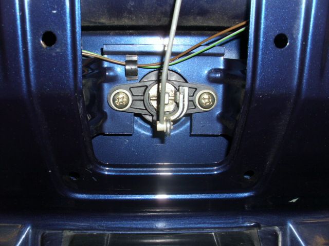

Second way, remove the parcel shelf, You don't need to lower the seat back just pop it up off the clips then work it out. You can then get to the cardboard cover that is over the locking mech, Could be the spring is out of position or the clip on the rod.
Once you get the cover off then push the rod down.
Boot should open.

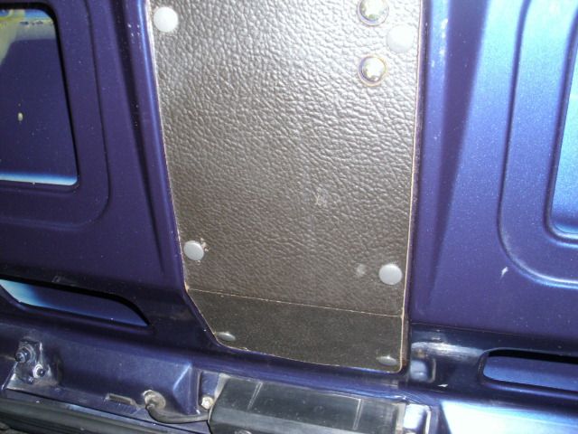

I have removed the panel that Briano1234 showed and there is some play in the lock.
