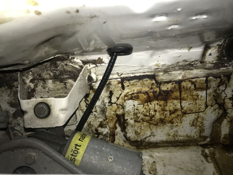

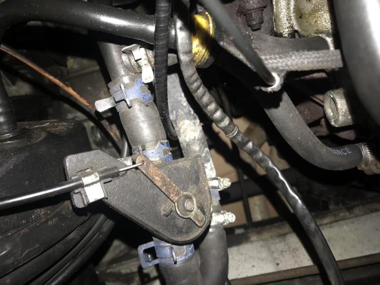

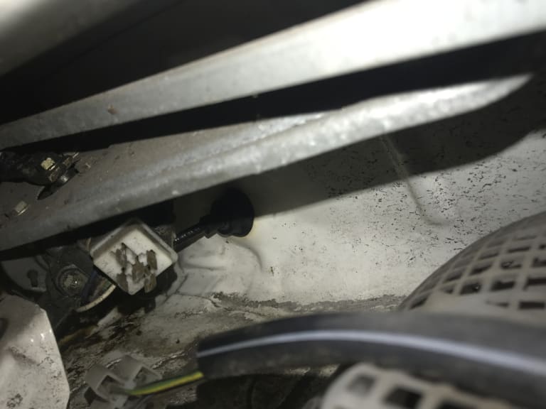

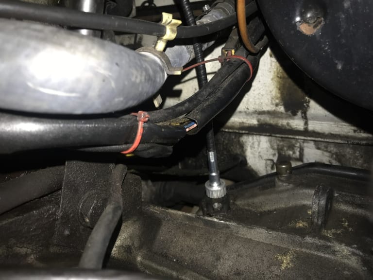

Here are the pics,
Note that the last one shows the cable going between heater pipes..thats how the original one was routed..not sure if thats correct!
IMG_9856.JPG IMG_9858.JPG IMG_9859.JPG IMG_9863.JPG IMG_9864.JPG IMG_9866.JPG IMG_9867.JPG
