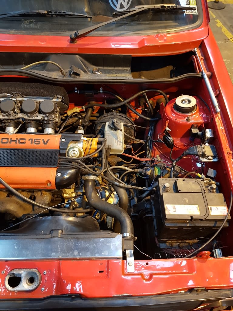

The engine bay is a maze of wires it's not all standard stuff who ever had it before me has bodged a lot of things so all the wiring is different colours mainly red ,😔😔

Are you trying to use the original coil or have you got one from a T-25?
You need to remove all the wires that were originally on the carb and the wires that originally went to the dizzy as they are no longer needed.
I'd suggest you also have a look at all the rest of the wires and see what is actually required and what isn't.
Looks like you have a lot of fuse holders that probably went onto the battery directly. These aren't standard. Do you know what they go to?

Well I for one have never seen anything like that before.
Shocking, sorry but it must be said!
Well take good notice of what Ian said above but seeing that even I couldn't live with that under my bonnet and I'd go to a Professional to get it all sorted out no matter what the price is if I want a car that isn't likely to catch fire at any moment!

Yeah the other engine run ok
I got a wire loom with the engine but I've just tried using what I already had in
Is it wise to have the loom put in?? I also got a coil with the engine I'm using that one

You got an engine loom with the engine you fitted, I presume that loom was working with that engine at some point yes?
Take your old engine loom out completely if so and replace with what you were given.

The Engine came from Unityneil and it ran perfectly in his car. The engine and wiring were put together by a good friend of mine by the name of Vic (if you know mk1 Derbys then you know Vic!)
If you got the coil with the engine then you're sorted, but you will need to run the loom you were given as otherwise the engine doesn't know when to fire. Hence the not starting.
