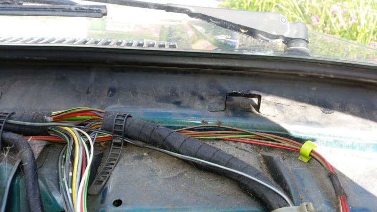

PNERivage said
Kenneth.. When you say 'mine was too far gone'. What are you referring too?
Sent from my D6603 using Tapatalk
These areas hold a tight clip that stop dash flapping under the window. If I've mine you've had water ingress constant evaporation and condensation weakens dash in that area
On the drive
Myvalver 89 GTi Grey mk2 16v
Use the Drywall tape (nylon woven kind not paper) JB-WELD and or plastic wire ties to strengthen it. I did on one that tore…. Worked really good, also tightening the clips works well also.
If you look really close at the edge you can see one of the clips that came loose of the windscreen clip.
