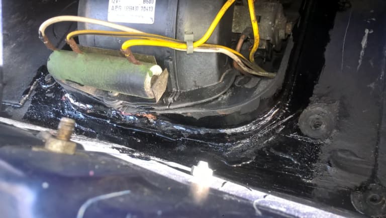

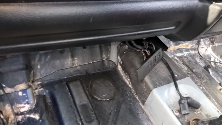

carpet and centre console are already out.. as I am trying to find another leak through the bulkhead

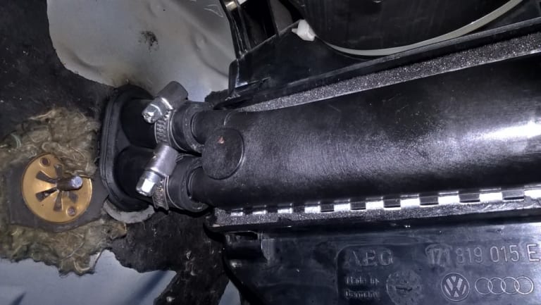

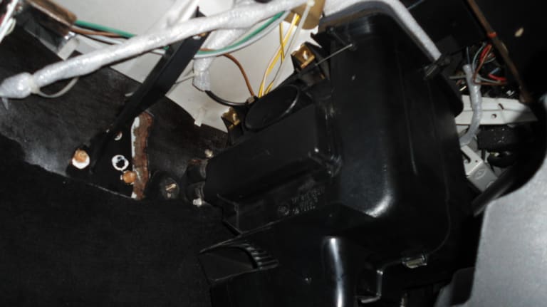

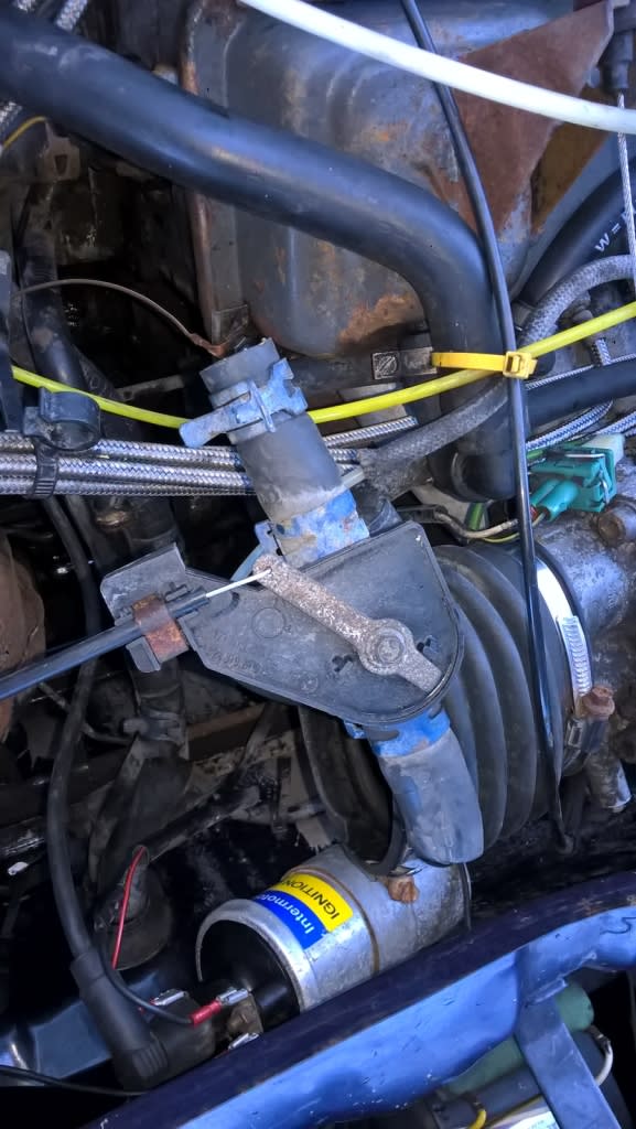

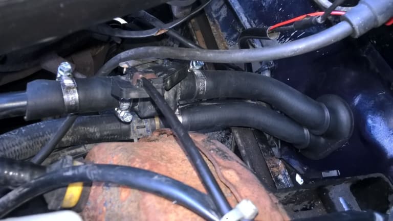

Made a start today when I had 5 mins.. I am changing the pipes and the grommet thru the bulkhead too. I have some hose pliers.. Couldn't get access to one of the clips so cut through it..
Will make a start from the inside tomorrow
As you pull the hoses through the firewall have a bucket handi, then if you can blow air in to a hose and catch the dribble in a bucket on the other side.
I am not to fussed about the water

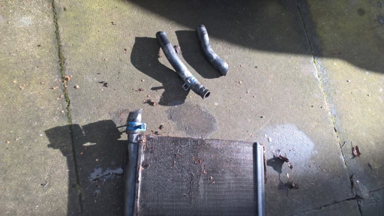

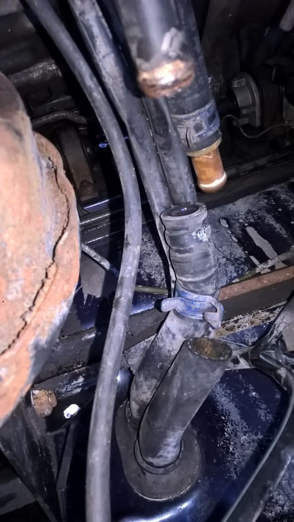

As vw had managed to put the interior clips round the back of the pipe I couldn't get to them with my hose pliers so I just cut them off too. Matrix is out

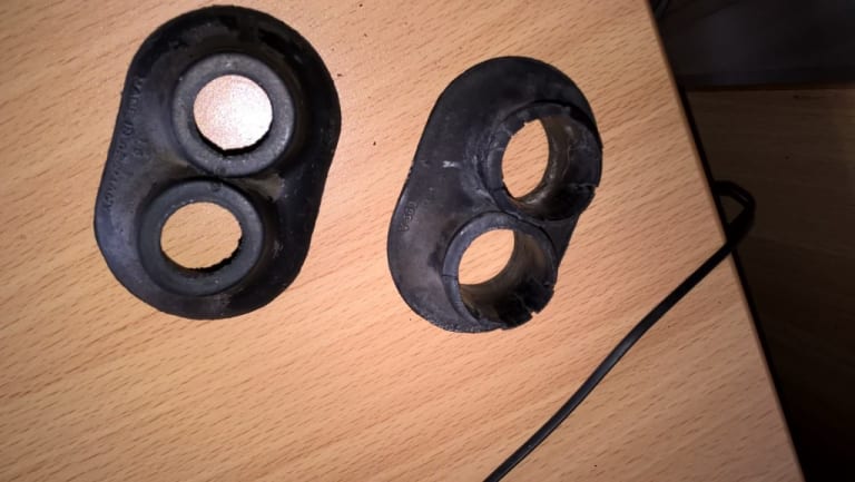

Job done.. quite a simple process really.. some more pics.. thanks for the guidance :-)
Do yourself a favor. Replace that plastic butt-to-butt connector. Go yo a hardare store and get a Brass Barbed Hose repair. That plastic piece is old, and weakened. It is a time bomb on your ride that will fail you.
