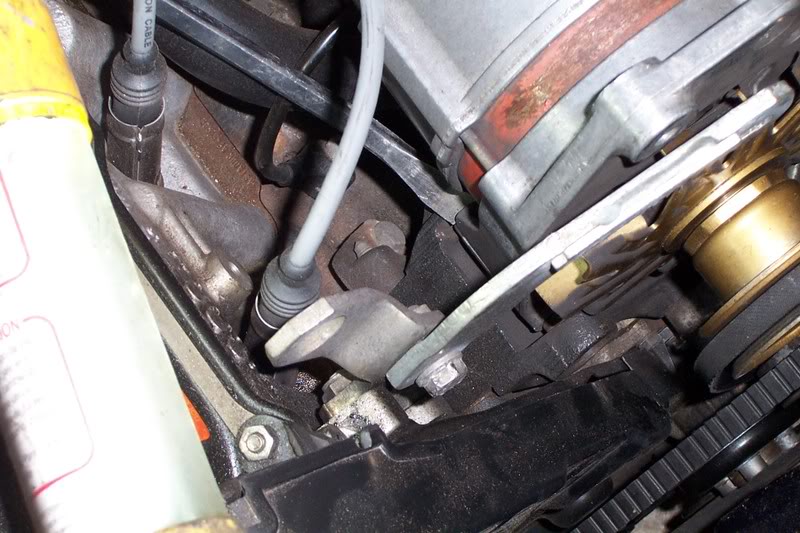

Typical non a/c mount.
Which is also the typical a/c bracket mount.
While if you have space, which is going to be tight, you might try to get a ratcheting spanner in there.
30 is the bolt you are referring to?

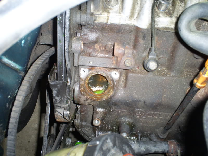

This shows you the a/c bracket which also holds the water pump's lower 2 block bolts.
This is the bolt?
Not a lot of clearance.

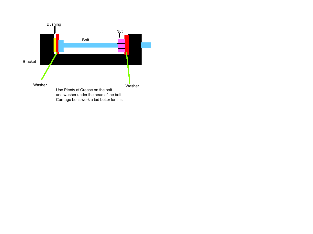

Number 20, This bushing has to be knocked towards the fender, and that is what is binding the Alternator, and if it hasn't been moved in a while can rust bind the Allen.
You can see the distance that the bushing goes in as you tighten the allen, and you can see why you have to smack it back to the fender to ease removal or replacement.
To totally remove it and clean it you have to press or bang it out.
I usually remove the bushing, clean it and the Bracket, then Coat it with never-seize.
