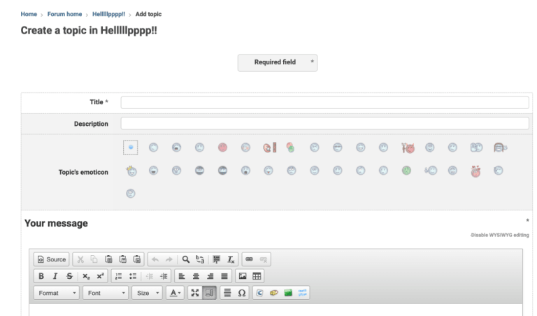

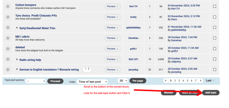

Sorry this is way off topic and this is my 1st post .
How do I start a new thread of my own ? I can't find a "create topic" button
Open a Sub Forum. Then scroll down to the bottom you will see the ADD TOPIC. Click the ADD TOPIC button.
It will then open a new window in the sub forum of your choosing.
Should be an 'add topic' button at the bottom of the list of topics (if you are logged in).
