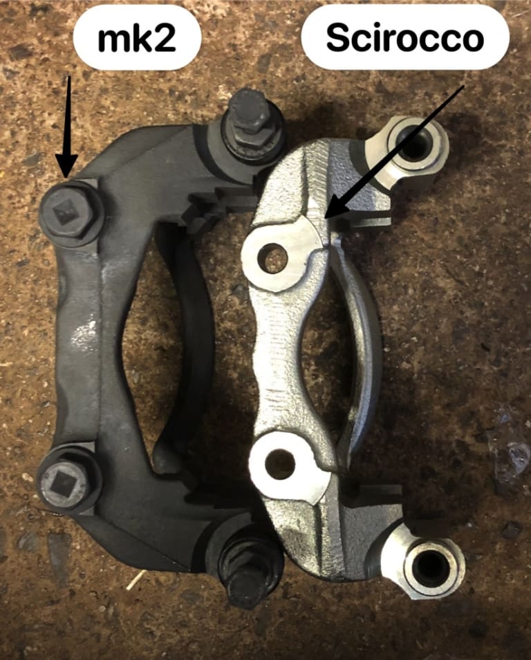

I bought what I thought were 256mm with mk2 carriers. I then got the Scirocco 16v carriers:

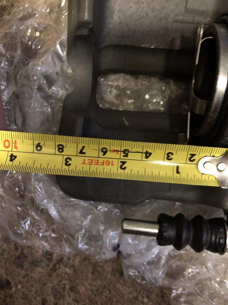

But looking at the calipers, they seem to be 280mm:
Question 1)
Are the carriers different for 256 and 280?
I am guessing they are as I think someone said you can use 280 carriers with 256 calipers (after some filing)
Question 2)
If I need new carriers and the Epytec adpator for the 280, is it better to sell them and try to find 256? Or should I sell the carriers and keep the calipers?
The calipers are freshly sand-blaster & rebuilt and they look mint.
Question 3)
Will the 280mm even fit in the cabi 15" Le Castle wheels?

It seem the Epytec adapter doesn't need a custom carrier, it works with the carriers that came with the 280mm disks.
