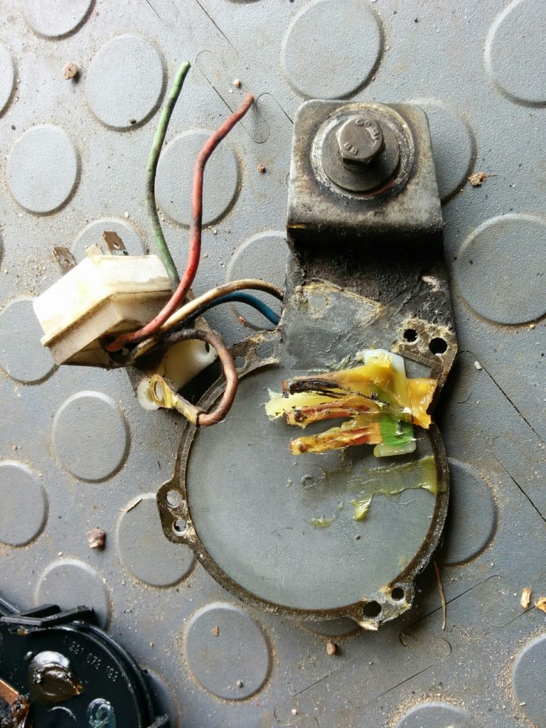

Firstly, I'm trying to do the mk3 wiper motor upgrade (following this link: http://forums.vwvortex.com/showthread.php?3465098).
However, I got the the stage of removing the backplate from my mk1 motor (I have the SWG one) and the same from the mk3 motor and I suddnely went…oh….that doesn't look right.They seem to be facing different ways, did I accidentally buy a mk3 motor from a left hand drive?The mk3 motor had no backplate, only the plastic clipped one…meaning I couldn't attach the mk1 backplate to it!So what's the part numer for the mk3 motor I "actually" need?! Thank you! Secondly, my cigarette lighter never worked so I thought I would have a look…obviously doesn't work because someone took the connector off and threw it away apparently!Anyone know the part number for the female connect for my cigarette lighter? Thanks!

I recently got a MK3 motor and like yourself discovered it had a plastic clip on cover and thus was unable to swap over the backplate.
I then tried to put the complete gearbox section from the MK1 onto the MK3 motor, but no joy there either, slightly different diameters.
So I just skipped all the messing about, bolted the MK3 motor in as is, and made up a short loom section to connect it to the original connector, IIRC I used 2.8mm males at the motor end and 4.6mm male connectors at the other. Used the Haynes manual and online standard din wiring charts to figure out the connections.

yeah, could have done. So you ended up not having it bolted to the support? (I mean, the mk1 motor backplate has that single M6 bolt to the scuttle, mk3 motor doens't have that)
Yep, no support bar, similar to how peeps normally change to the MK2 motor. No problems so far although I do intend to make a support when I get time as it certainly can't hurt and will reduce the stress on the spindle locations particularly in light of the extra weight of the newer motor.
To make the wiring easier you can always cut the plug off the original motor and graft it onto the MK3 motor, makes it easier for any subsequent removals compared to the individual pins I'm currently using. I intend doing that as soon as I get hold of the portion of the Mk3 loom that connects to the motor to make a better more easily removable configuration.

Thanks, seems like all the mk3 motors are "handed" differently…so that's not something I've messed up, which is good.
Seems though that I'm basically going to have to go down the line of buying a mk3 motor and just fudging the wiring.
Anyone got a wiring diagram of how to wire up the 5 wires on the mk1 motor connector (SWG variant) to the mk3 motor?
Just FYI all, I have found the part number for the exact mk3 motor you need to do the "easy" swap…sadly the only ones I can find for sale are in the USA and are around £45…eek
1HM 955 023 C

For the sake of science I have taken the plunge and ordered one of the mk3 USA spec cabrio motors from eBay to try and do the conversion as on vwvortex. I'm in a "do it once, do it right" mindset.
http://www.ebay.com/itm/Front-Windshield-Wiper-Motor-93-99-VW-Jetta-Golf-GTI-Cabrio-Mk3-1HM-955-023-C-/311373473997
I'll post up some pictures when I'm doing it to see how it goes. I reckon I'll need to jimmy the fixing point somehow because the motors are still "handed" differently, but I'm hoping to be able to utilize the mounting point in the end.
just bolt the mk2/3 motor straight on, no need to mess swapping bits about or worry about the 'handyness' in a mk1 as there is stacks of room around it. for the wierign you simply chop a length of loom off a donor and match the colours to the mk1 plug. either splice the wires or crimp male spades on and pop them to the plug.

Just a heads up for anyone who cares / wants to do this themselves at some point. Changing the mk3 motor to a USA mk3 cabrio (1HM 955 023 C) does work from a mk1 SWG motor.
Just got it up and running in mk 1983 3 door. The backplate of the mk1 motor does require modification to get it to fit the mk3 motor (holes drilling out bigger, extra holes drilled, edges taken back for clearance etc) but it did fit :)
