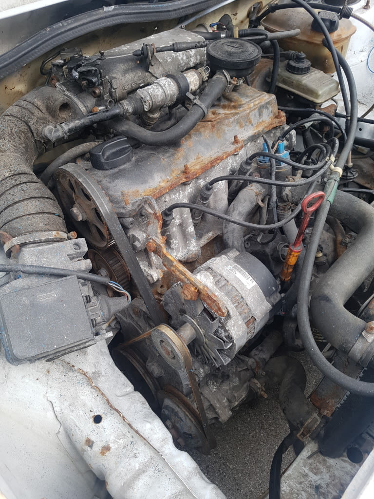

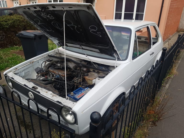

I had a engine put in by an apparent top vw garage, after months of waiting I got the car back not running correctly and has pretty much been sat up ever since (5 years or so) I've tried to start it to no avail ok just need someone who is capable to have a look and either get it running or let me know the engine as I expect is a bag of .if anyone can help me in the bristol southwest area I would appreciate it greatly thanks also if this makes sense to anyone can you please let me know what combination it is but I was told it's top 1.8 16v mk2 and bottom 2l 8v mk3 I have no idea what parts I need i.e. mk2 or mk3 starter motor ect
There will be a engine code just below cyinder 3 spark plug on the engine block and that should tell you what engine block is in there.
What parts do you need as most service bits are the same for the engine.
I would also start soaking those rocker cover studs as they look rather rusty….
That cam belt looks like it’s seen better days, I would recommend fitting a new one and new cam belt tensioner before starting the car.
