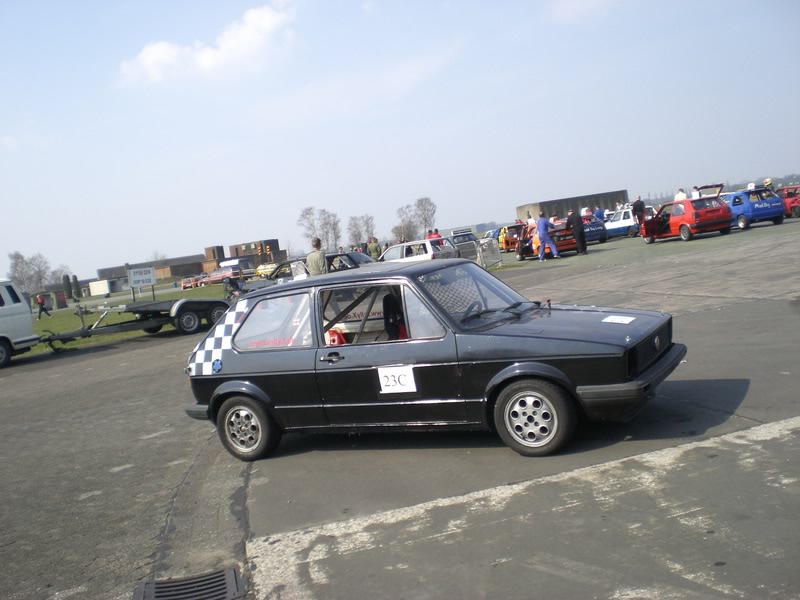

I got my golf on the track in quick time altough it wasnt running perfectley i just wanted to get out there!
Only 1 problem really, when i initallialy put my foot down quickly it splutters a bit sounds like a v8 then the revs catch on and revs higher, its the inital start of putting my foot down fast. when i slowly put my foot down to rev it ok.
