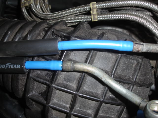

I consulted the manufacturer regarding its use with petrol…. No probs he said….. Once sweated on (see below) its OEM and a fraction of the cost of braided and safer than rubber, Its available in various colours and once sleeved see second pic (for added protection) will serve you fine. I did this in the engine bay to protect from heat.
This type of hose is used on many modern VW today, I know my mk3 tdi has nylon lines.

Dip the end in boiling water, this will cause the tube to expand slightly and become more pliable.
The ends of the metal pipe are ribbed, look closely you'll see, spray a touch of wd40 on the metal bit and offer the nylon up an push on.
Leave it cool.
Done. No need for clips.
clips will damage the nylon. And if it's Good enough for Vw on the kr engine and all the newer engines, it's good enough for mine.
