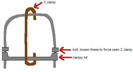

Here is a very simple and cheap way of getting the "C" Clamps on and off the dreaded Carbed version exhaust/manifold system using a new Exhaust clamp. The exhaust clamp will open and close the C clamp as shown in pic.
I did think about making a tool solely for this purpose now that i have a magic electrickery tool. A MIG welder!
Hope the info helps

I love it, what a simple design!!!
