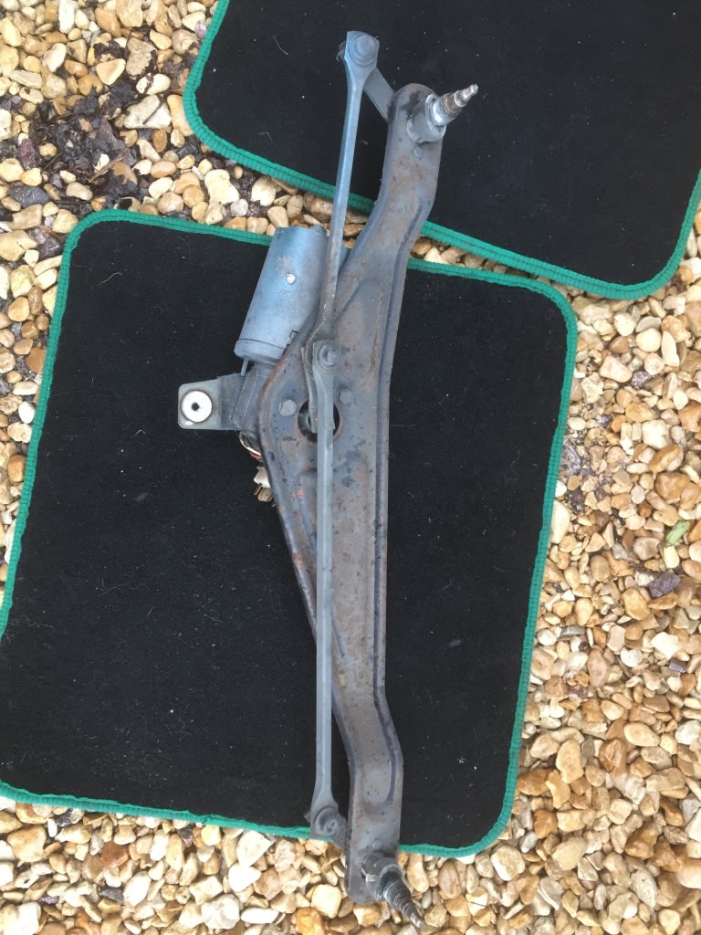

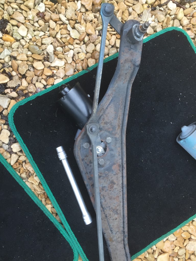

Hi yes very easy to fit, of course the new motor doesn't come with the bracket that fits to the bulk head, it seems pretty solid but I may mock up a bracket just so it doesn't stress the panel that the wipers fit to. Here's a picture of the new motor fitted to the linkage:
the replacement motors sit on the linkage a little differently but there are no issues with clearance
Old motor

Old motor
