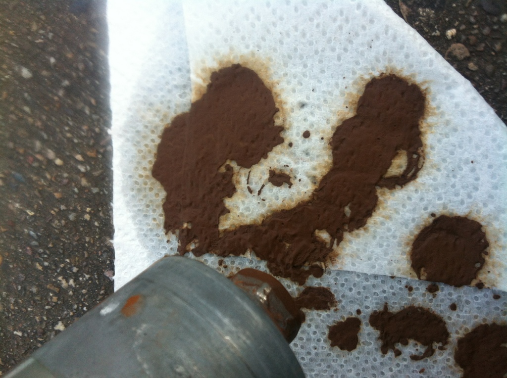

rubjonny said
ok nerxt step i would have a good look at the filler neck and inside the tank, plus check the inlet on fuel pump as per:
The Mk1 Golf Owners Club
Hey that's a great thread, very helpful. It's got to worth doing that anyway, maintenance wise.
Cheers for that and thanks to Chudd for posting the OP.
Andy.
Mine was full of tiny rust particles too.
No wonder the pump was working hard and drawing too much current.
