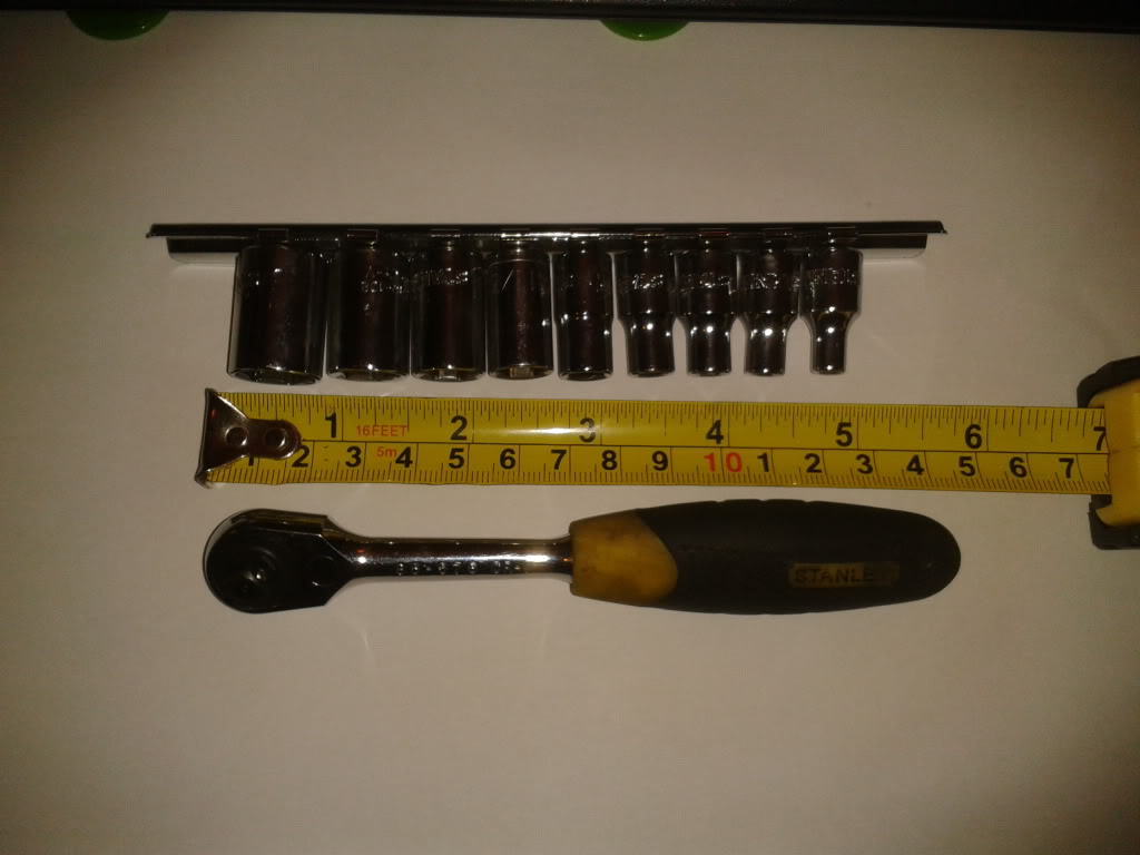

As for getting the switch out, yes it is a pain!
I did muck about with my normal ratchet for a few hours and just could'nt get enough movement on it to turn the bolt so bought this,
cost about £15-20 (can't remember exactly). It's still a fairly slow process in removing as leverage is limited and bolts fairly long, but does get them out. Mine were also normal head shaped bolts.
