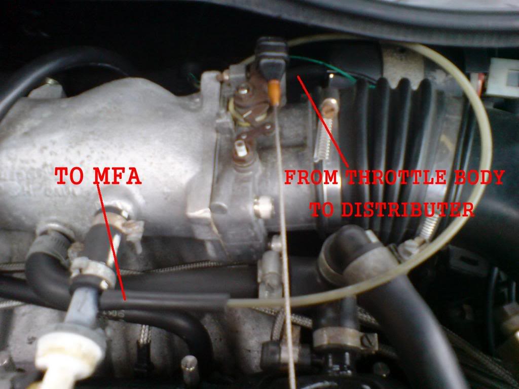

I've disconnected the vacuum feed to my mfa, after accidentally snapping the connection at the black/white valve in front of the plenum, above the cam cover while doing another job. I sealed up the hole to the broken valve to prevent loss of vacuum to servo.
Strange thing is, the mfa reading still reads very high, and still varies roughly according to how the car is being driven…ie even higher readings when driving gently, lower readings (down to 52mpg…ha ha!) when driving more briskly. This is happening with no vacuum feed to the mfa….
…spooky!
