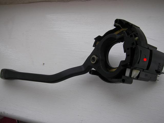

Check pin 30 (red/yellow) & Pin 56 (white/black) on the flasher connector.
Pin 30 should have 12v all the time
Pin 56 +12v when the ignition is on

Lights off - Unable to Flash
Lights on sidelights - Unable to Flash
Headlamps on - Able to flash
Any ideas??

do i need to dissassemble the steering column? or is it easy to remove the stalks??
Also you mention Washer stalk…do you mean indicator stalk? i thought the flasher was on indicators?
