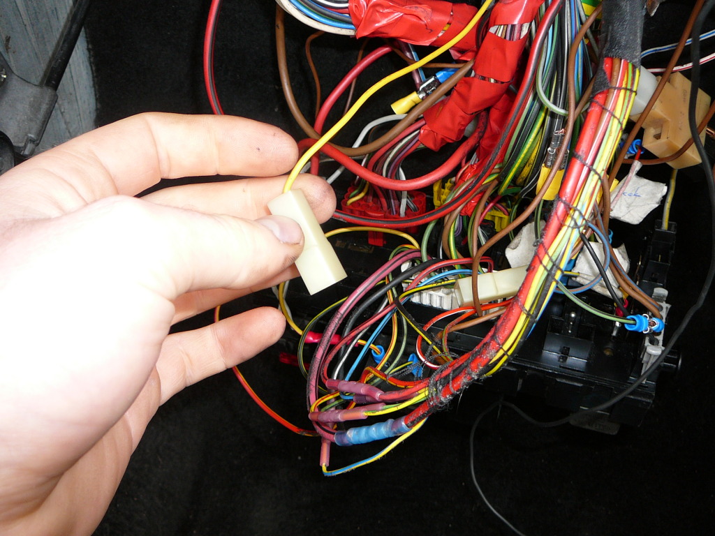

The light for the indicators goes solid green when the stalk is depressed up/ down but it doesn't click at all- not going through the relay ?
So after wiring everything up I've ISV etc as ignition live, and the injectors as a permanent live. But have these left over.
Solid yellow wire/ spade connector+ plug. Has no voltage.
And this rather fetching green& white / blue&pinkish colour wire that goes into a single spade connector+ plug. This one does have voltage
These related to my problem or is this something else entirely !

yellow wire is probably for 0.3bar oil pressure switch, leave it for now though.
green/grey and blue/brown is fgor the handbrake warnign light, there should be a wire to the handbrake switch that plugs into this

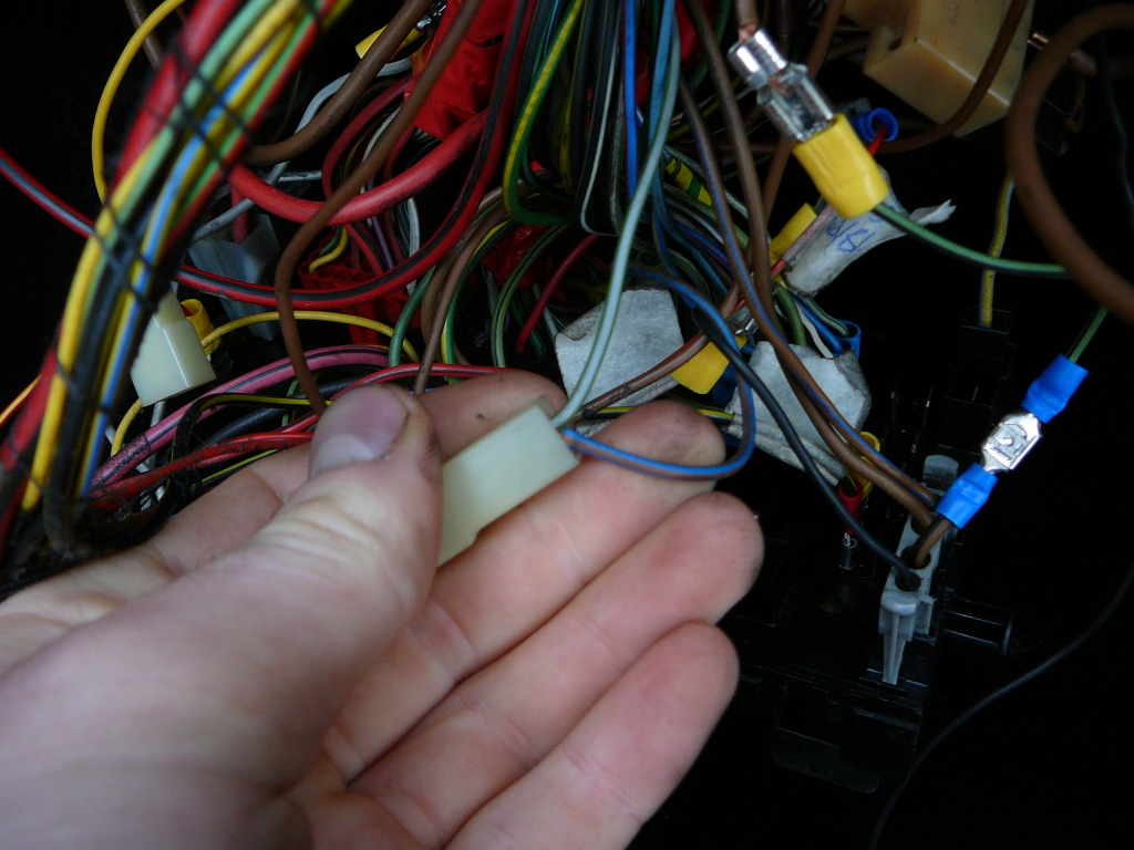

Also checked the free wires at the back and found another……. from the dash loom
Green/Grey and Blue/brown : 0V
Yellow : 0V
New found one - Solid brown and a Brown/White to a single spade connector/plug : 3.4V (This be an earth?)
The blue/black wire to the back of the hazard switch is reading 11.94V also

I've traced the brown/white and brown wire(s) that read 3.4v,
*Brown is on the large plug for the clocks
*Brown/white goes to the wiper stalk,
So guess their the MFA? and don't really need connecting to anything unless they are earths?
Yellow again I guess is for the oil pressure like you suggested as the oil light is permanently flashing lol
And the green/grey + blue/brown as you have identified is for the handbrake.
Only thing is what the heck is missing now lol, I can only think that there is a live connection missing somewhere as so meany fuses have no power to them!?

yah sounds liek oil pressure, it should run to the blue/black wire on the pressure sender on the side of the head.
if you have ignition live to the black/blue wire then id say the hazard switch has gone, i take it the hazards work ok? if so the wiring to the lights is all ok at least

Earthed the brown + brown/white spade to the earth ring. - No sure if I should change this to somewhere else?
Reconnected the grey wire to the ignition switch, hey presto there is life! Left, right and hazards all now work
Only thing, with the key out the ignition when you put the indicator up the corresponding light turns on at the front ? :dontknow: This normal? haha

the grey wire is for the parking lights so i cant see how they could have fixed the rest of the indicators but hey ho
what you describe is the parking light system, so normal

Think it was the hazard switch completely! Not completing the circuit, swapped it for a spare I had and it sorted everything out. I took the old one apart infact, found it had no internal slider part…. so was never going to work lol!
Great stuff I started to think it was another quirk it had developed like its ability to choose when to start or not haha, nice thing to know about them parking lights!
Two other quick questions though!
The handbrake light, does the black wire from the dash connect to the fusebox at ign live? then the wire from the handbrake spade connect to the green/grey and blue/brown wire? confused my self! lol
And the yellow wire - 0.3bar oil press, what would this connect to being a G60 conversion ?

pretty sure the 0.3 bar switch should be on the side of the head, it sits in a t piece for the charger oil pressure feed
