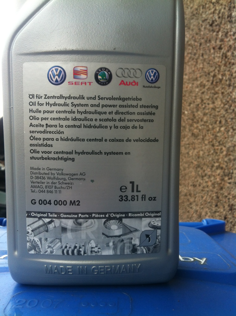

G 004 000 02 Hydraulic fluid for power steering and power roofs - Just pop down to your local VW dealer, it is still use in the latest cars.

Just spoke 2 vw in colchester and they have got at oil for the roof :)

This is the oil

cheers every one for your help!!!!! i changed the oil 2 day:) and its a big thums up :) all is working fine. and yep thats the oil i got from vw :)
