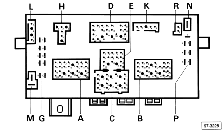

im redoing my electric windows in my cabby as it had after making ones in. ive got a 191 959 875 box with the 3 plugs in
and all the wiring loom i need to know how to wire it in or a wiring dirgam please keep it simple.
i would be really greatful if someone could help.

There's not that many wires to connect up on the loom. There's a fat red wire that connects to the back of the fusebox on the spare spades in location P:
There should be a narrow black wire that goes to Pin 15 in location D on the image above and over on that side there's also an earth wire that connects to the crown of earths up by the fusebox.
Then there's 2 more earths next to the control unit (black box) that earth to the body (I drilled a small hole in the box section and used a self tapper). This mounts up under the dash on the drivers side ( I used double sided foam tape to mount the control unit so to avoid drilling through the bulkhead into the rain tray):
The other connections are just to the switches and motors.
Hope that helps!

Can you take any pics?
I also forgot to mention one more wire on my previous post, it's a thin brown wire and should have a spade connector on the end, this connects to the back of the door switch for the interior light. Use a piggy back connector for that.
If you look at the picture above of the black control box you can see the connectors on that, have you get them all plugged in?
