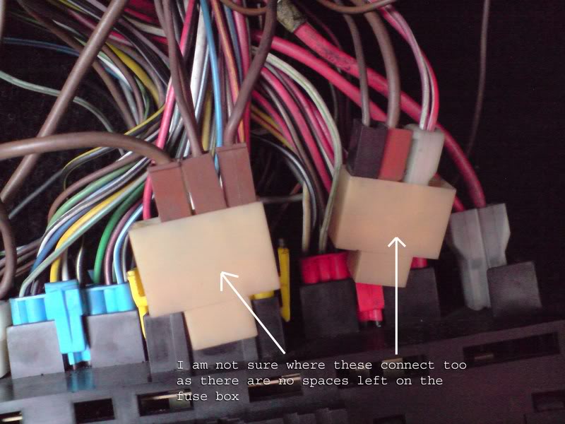

I am in the middle of an engine conversion (1.8gti) im not going to be using MFA and im stuck with a few wires.
The pictures below pretty much explain it.
So if anyone knows where they may go it would be a great help.

I presume this is just a case of either i have wired the loom wrong at the fuse box or the earths arent doing there job.

Earth blocks ………….should be earthed not connected to the fuze board . Look for the earth rosette above the fuze panel and make sure a wire goes to it from those blocks .

Always seems to be the 4 way flasher switch to blame for this , try a new one it can cause havoc in the dash . I have never had a faulty one but plenty of peeps have . Its a start anyway . Your loose  wire what colour is it , straight Blue ?
Thanks for that :)
Yes its blue straight through,just has the black water tight wrapping around it.
by the looks of it, that blue wire is from alternator to the clocks for alternator warning light

call me stupid,but in that case it should connect to the alternator directly or indirectly through a block of other wires?

sorted both problems now,
