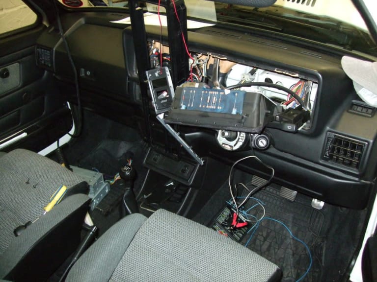

After pulling the dash apart to get the instruments out, pin 7 blue and white wire on the multiplug to the instruments (as per Haynes and Autodata books) is +12v when the main beam is on and 0v when off so it looks like all that is working OK and the fault is with the instruments. :cry:
The blue plastic membrane is ok with no burns or rips, looks like its never been touched before.
The warning light is blue unlike the yellow LED used on MK1 tin tops, I seem to remember reading that when the MK11 came out VW used an ordinary filament bulb behind a blue plastic cover as blue LEDs weren't availble so perhaps its the same on a '87 Cabrio and the bulb as blown :dontknow: There doesn't appear to be an easy way to change if that is the case
Has anyone dismantled an instrument cluster and can give me any clues on what to watch out for??? It all looks very delicate with lots of clips/screws/nuts and bolts.

Going to do a bit more prodding with multimeter and then decide wether to pull instruments apart.

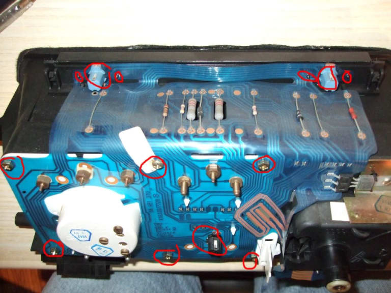

Decided to pull cluster apart;
1st remove cluster from car, on a MK1 this involves removing half of the interior first…
To dismantle the cluster I removed the 8 screws (two not shown in pic to far right) and the lights that hold the blue circuit board down, highlighted in red….

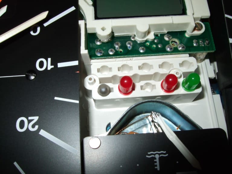

This then allowed me to gently lift out the 3 main components (rev counter, LEDs/fuel gauge and speedo) as one held together with the blue circuit film from the cluster housing. Then when turned over I removed the black plastic LED 'shield' to reveal my problem. As suspected when built there were no blue LEDs so VW used a clear LED/filament bulb that had blown and a blue plastic mask;

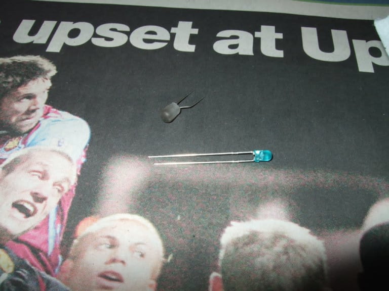

Off to Maplins to get a blue LED, unfortunately they only had chav type bright blue LEDs, I got a clear one and this other shown with the original blown white LED style filament bulb. They were 3mm so could be used under the blue plastic mask so not a big problem. Insert the right way, short leg or flat side = -ve connection;

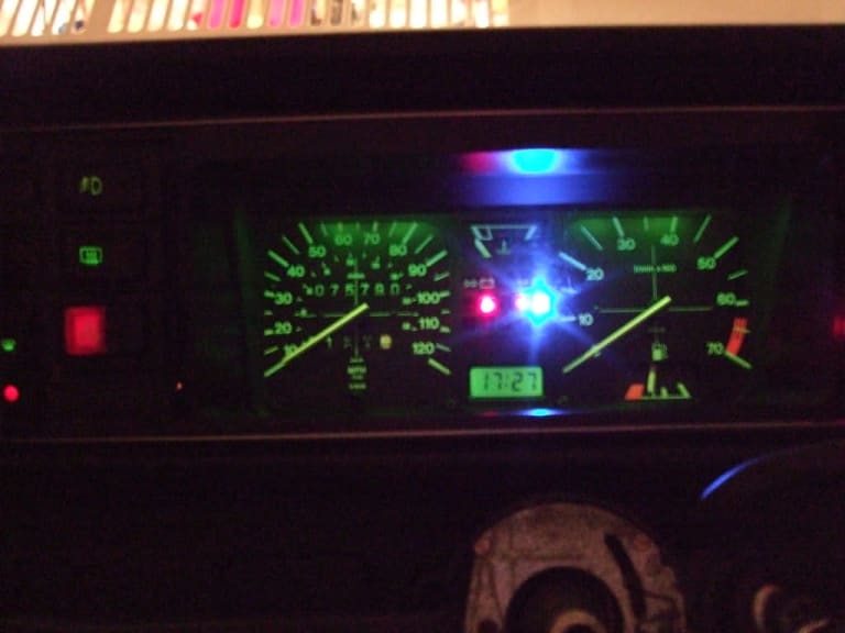

Put everything back together and test. Is brighter than the other LEDs but not as bright as camera makes out;
Job done and I now know a little bit more about MK1s!

If I was to do it again I would have used one of these lower 1.5cd output LEDs;
http://www.maplin.co.uk/module.aspx?ITAG=SPEC&ModuleNo=35733&doy=31m12#spec
instead of the brighter3.2 cd type that I did use.

Just ordered some from Maplins
Thanks for the tip!
