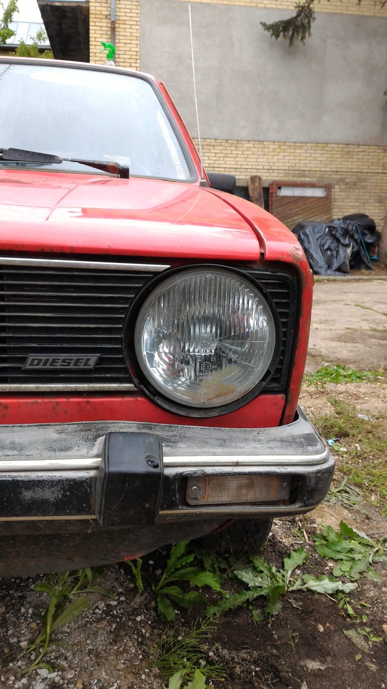

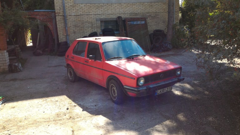

Here is my mk1 on which i'm trying to work on! (in the picture it's not even touched yet!)
I think it looks fine with the bumpers it has got, but each one to his own…
For a swap to the 1.6TD, as far as I know the only difficulty is the downpipe, which you will probably have to make up yourself. Apart from that, a bigger intercooler, etc, will increase power with the pump adjusted, bit will also increase smoke.

Yeah, now i thought so as well, that it looks not that bad, because i saw prices of those smaller bumpers, which i thought looks better, and it's about 120 euros.. it's On ebay, so i don't know if i could find those things cheaper to buy.. I guess i'll just try to renew the colour of it, if i won't find anything better, by the way, is the heating way of renewing the plastic is the best way to do it?
