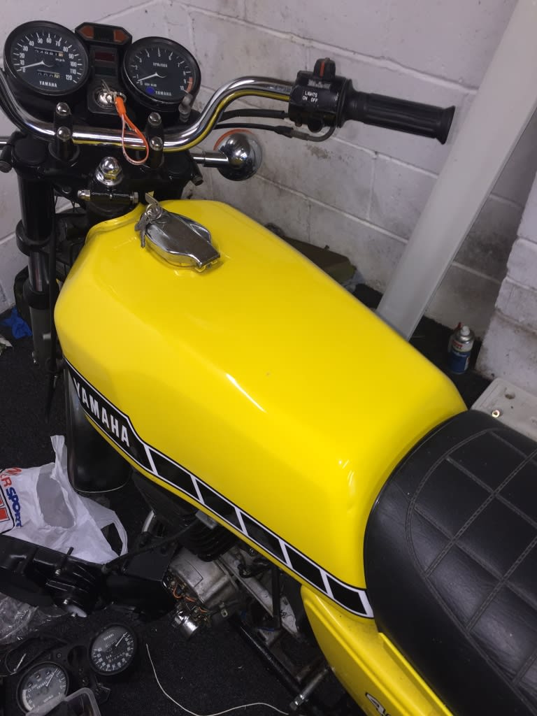

Highly recommend this DA polisher!

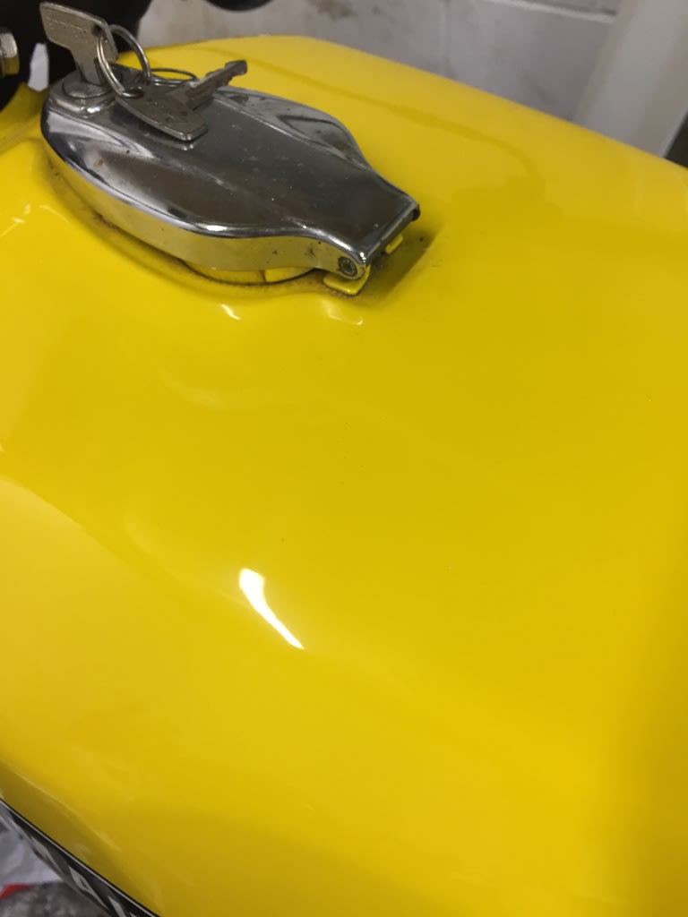

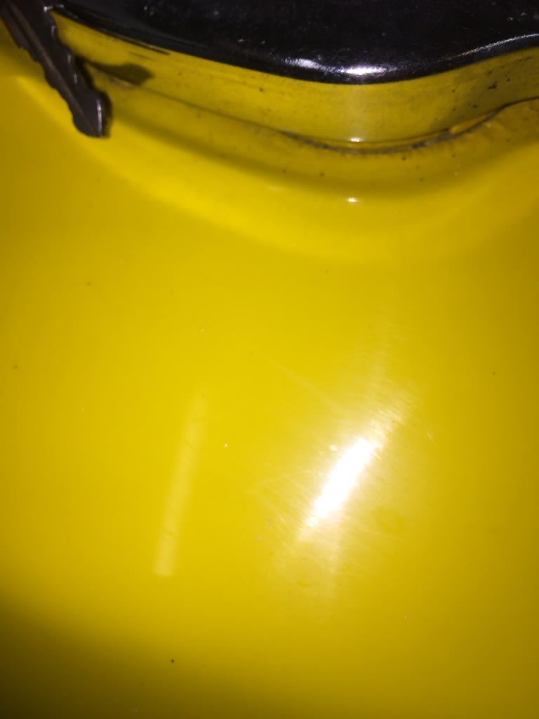

Before
After

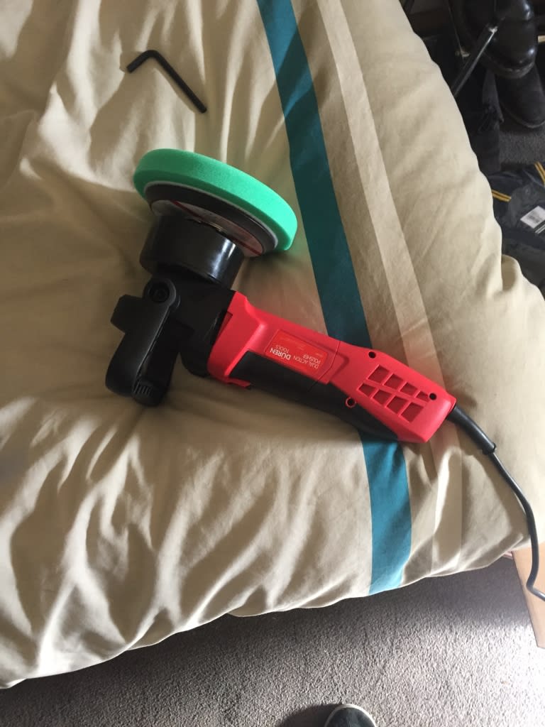

All the kit you get, the waffle weave towel was a fiver from euro car parts

Cheers! My thinking was well rather than paying someone nearly that amount of money everytime I need a car tidied up, why don't I just invest and learn it myself? Glad I did and can't wait to use it more, also pretty much impossible to damage the paint with a da unless you throw it at the car lolP0jy said
Good result that!

There is fast cut XL also, it's a bit wetter, not quite as much cut but gloss should be slightly better.
Green top is the 1st of 3 stages in 3M's recommended colour coded system.
2nd Yellow top Extra Fine Plus with yellow waffle sponge
3rd Blue top Ultrafina SE with blue waffle sponge, though this is only needed for dark colours.
